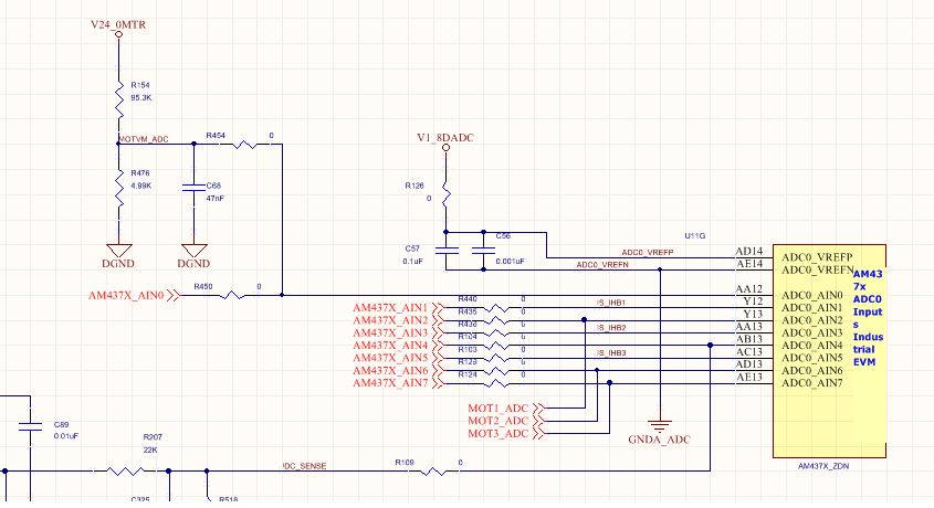

The schematic diagram for am437x IDK provide that there are 8- ADC pins available for user to use as GP ADC , the provided schematic as the following shows  :
but the problem is the kit provided  from TI has a missing or (not found )  component :

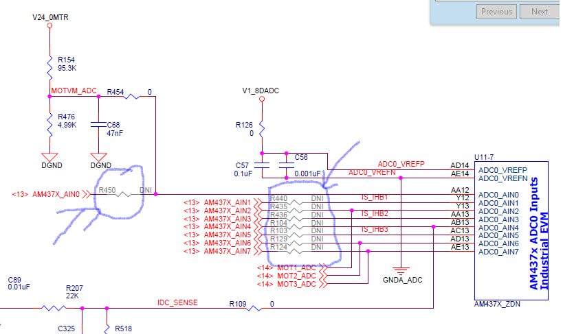

the schematic shows that are 8 (0 Ohm ressitors)  that connects ADC pins to  jumper (J1)  but in hardware the following resistors are not found : R440,R435,R436,R104,R103,R124,R129,R450.
I had captured the following photo to the provided kit that might clarify  the previous situation  :
As another proof when i short circuited this open pins (for the missing component ) and inserted an analoge voltage on the ADC_pin  i got the expected reading . The main question is how to solve this hardware issue ????? !!!!!!!!!!!!!!!!!!
