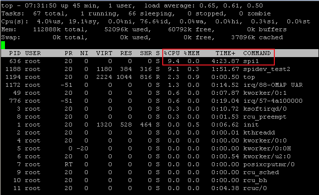

I tested the spidev_test in the kernel/Documentation/spi/spidev_test.c and use top to check the CPU loading.
just adding a while loop to continue the SPI transfer.
CPU is fixed at 1Ghz, testing at both EZSDK7, and 8.
1. When SPI clock is set 500Khz as default, the CPU usage is 14.6%.
2. When SPI clock is higher like 24Mhz,  the CPU usage can be reduced obviously.
It looks like the time is took by spi1 driver doing the I/O.
Is this result normal that I get a really high CPU loading when using a 500Khz SPI transfering? (My client need it to work at a lower frequencies.)

    Biser, is correct in his statement, that the while loop is loading the cpu.  In my understanding it is fine to see this behavior, when you test spi like this (with a  loop in spidev_test.c)

    CPU load is 14%. Here is the explanation:
    In user space a C program is executed at several hundred KHz speed. So, when you call the spidev_test.c WITH a while loop in it the loop increments with a speed approximately equal to the spi tranfer executed by the transfer() call, so CPU waits for the transfer (since they are equally fast) which loads the processor.
    On the other hand a shell script is executed far more slower (several KHz speed), so when the shell script steps in the transfer() it takes longer time to go to the next call in the spidev_test.c & the spi transfer is executed by then => cpu does not wait.
    The behavior is similar in your case:
    When working with 400KHz spi transfer speed, the spidev_test.c is executed equally fast as the spi transfer => cpu waits & is loaded.
    When working with 24MHz spi transfer speed, the spidev_test.c takes longer to step through the calls, allowing the transfer() to execute while the pc steps over the program.

    The problem we faced and the test you've done, actually has a little different.
    In your test, calling the transfer() in a while loop without any delay.
    In our test, we put a 5ms delay after calling transfer().
    The transfer function sends 38-byte data with a 5MHz speed.
    The time for transmission would take about 0.07ms. (1/5MHz * 8-bit * 38-byte), so we think, to put a 5ms delay should be enough.
    But we still can see the CPU loading on spi1 is still quite high, 9.4%.
    The purpose of the test is to simulate controlling a low speed OLED panel. A short delay between two commands is necessary.
    Can you give us some advice to lower the CPU loading?

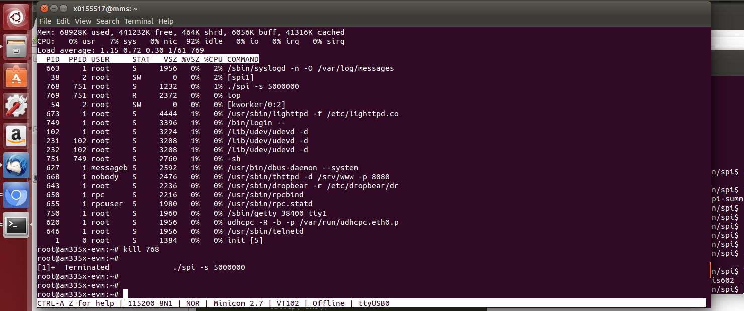

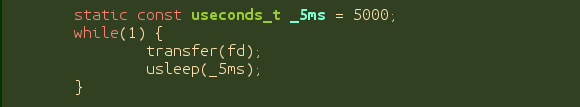

  • Hi Max,
    I did the same test on my side (BBB, running SDK2.0 kernel 4.1).

    I tested two options:
    1) delay in the while(1) loop:
     if (input_tx) {
    size = strlen(input_tx+1);
    tx = malloc(size);
    rx = malloc(size);
    size = unescape((char *)tx, input_tx, size);
                  while (1) {
      //transfer(fd, tx, rx, size);
                      transfer(fd);
      free(rx);
      free(tx);
                      //usleep(_5ms);
    } else {
                   while (1) {
      //transfer(fd, default_tx, default_rx, sizeof(default_tx));
                      transfer(fd);
                      //usleep(_5ms);
    2). Delay in the transfer() function:
    int ret;
    static const useconds_t _5ms = 5000;
    uint8_t tx[] = {
    0xFF, 0xFF, 0xFF, 0xFF, 0xFF, 0xFF,
    ret = ioctl(fd, SPI_IOC_MESSAGE(1), &tr);
    if (ret < 1)
       pabort("can't send spi message");
    usleep(_5ms);
    In both cases I see 1% cpu load for ./spi -s 5000000 & 2% cpu load for [spi1] :

  • On kernel 3.14 (SDK8.0) I see the following cpu load:
    Mem: 117100K used, 391996K free, 0K shrd, 692324K buff, 692368K cached
    CPU:   0% usr   5% sys   0% nic  94% idle   0% io   0% irq   0% sirq
    Load average: 0.27 0.52 0.30 1/59 2078
     PID  PPID USER     STAT   VSZ %VSZ %CPU COMMAND
     630     2     root          SW       0        0%      3%   [spi1]
    2073  2069 root           S      1172     0%       1% ./SPIDEV
