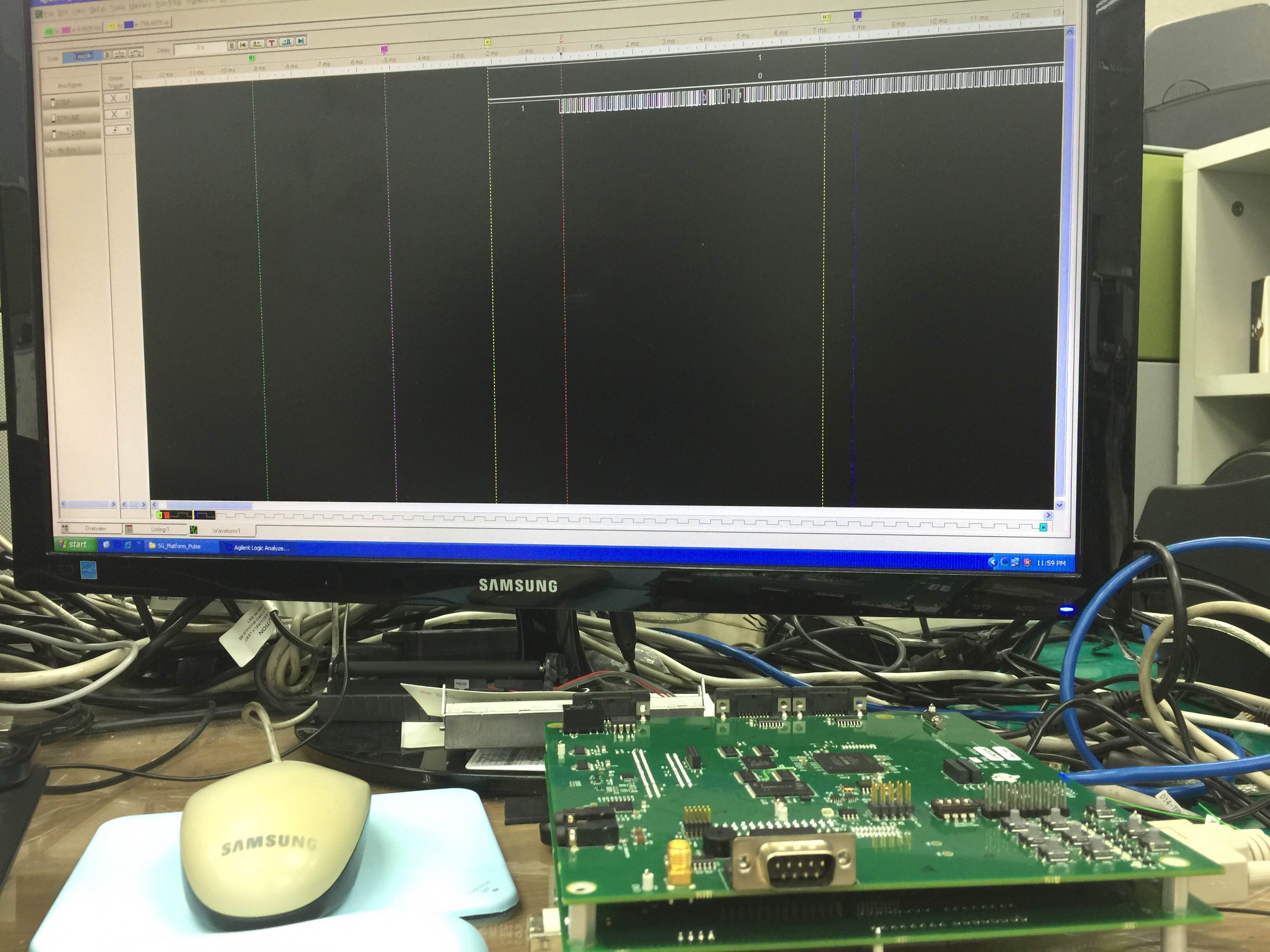

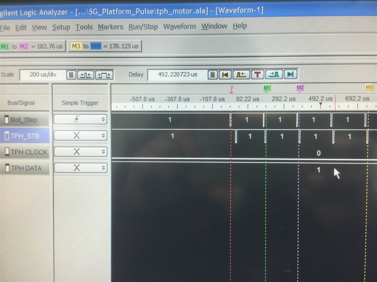

I tried to use two DMTimer (TIMER 4 and TIMER 7) on my AM335x Evm,
I configured Timer 4 to generate 180 Microseconds PWM and Timer 7 to100 Microseconds.
when I run both timer continuously, its working well, Timer 4 generates 180 Microseconds pulse width and Timer 7 generates 100 Microseconds pulse width.
Please refer the attached Logic Analyzer Pic1.
However, when I try to start the Timer 7 inside Timer 4 ISR Handler, its not working well, the Timer 7 pulse width is changed,
please refer the attached Logic Analyzer Pic2.
My requirement is, to start the Timer 7 Whenever Timer 4 interrupt occurs. DMTimer Start and Stop then start is not working as expected, please guide me to clear this issue.

    Hi Yordan,
       Thank you for your response,
    When you enable both timer4 & timer7 to run continuously, do you call timer7 inside timer4 ISR handler, or this call to enable timer7 is commented?
       Enable both timers inside the module init function, yes the commented enable timer 7 is correct,
    Is it possible to track register values of timer7 and timer4, when you start timer7 inside timer4 ISR handler?
           I keep track the Load Register, Match Register values, nothing wrong with the register values. It seems like perfect.

  • Hi Yordan,
        After analyzing this issue,I  found out, it's happened due to some random delay while calling the ISR, As far as i know, the ISR should be called immediately whenever the Overflow and Match Interrupt occurs, but in this case, the ISR is not called immediately there was some random delay, its about 60 microseconds,  In my sample source code, used Auto Reload and overflow match mode that’s why, whenever the overflow and match interrupts are occurred the PWM is generated using the current register values, since the ISR is not called immediately the new value is not not taking effect the old values were used for the next PWM.that’s why the 65 microseconds repeated two times,
    How do we fix this random delay issue in calling ISR? In my Sample Source, already set highest priority(0) for the timer 7 ISR,  I think it's very critical one, please guide me!

  • Peter, we are still a little confused on how you want the timers to operate. Can you provide a timing diagram of how you want both signals to look?
    James
  • Hello James,
    I hope you keep track the history of this issue and gone through our sample source code as well, if so, I am pretty sure you will be well aware of our requirement. I am really sorry to say this, This issue has been reported on 22nd of December, 2015 however, we still yet to get a solution from TI, its really embarrassing, due to this issue our current project has been delayed almost 2 months. Hope TI will solve this issue ASAP.
    I will explain our requirements one more time,
    We want to use Two DMTimer, Timer4 for Motor Control and Timer7 for TPH Srtobe Control.
    We want to control the TPH inside the Motor ISR,  for every two TIMER4 Pulse, the TIMER4 ISR starts the TIMER7. The TIMER7 has to generate 4 pulses with different width and stop the Timer7 i.e for every 2 Motor steps 4 TPH pulses should be generated.
    For example,
    1 motor step = 180microseconds
    TPH Pulses = 110, 90,60 and 100 microseconds
    Motor Pulse:  180    ,      180,       180    ,      180,      180    ,      180,
    TPH Pulse   : 110,90,60,100,      110,90,60,100,      110,90,60,100
    Please refer to this picture,
     e2e.ti.com/.../MOT_5F00_TPH.jpg
    We want to generate this kind of pulse,
    Hope you understand our requirement, Please let me know if you have any concerns.
    Thank you,
    With Regards,
    Sahaya P

    Here is the Logical Analyzer Output
    In my Opinion it's happened due to some random delay while calling the ISR, i already mention this on my old post( Jan 25,2016), whenever the Overflow and Match Interrupt occur, sometimes the ISR is not called immediately there was some random delay, its about 60 microseconds (check the M3 to M4 on the above picture it suppose to be 110 but its 168 ).
    Here is my capture for the ISR Entry Timing,
    If you look at the above picture, you can clearly say that sometimes there is a delay in calling ISR. In my attached source code i used to a macro ISRCALLTIME to find the Entry Time.
