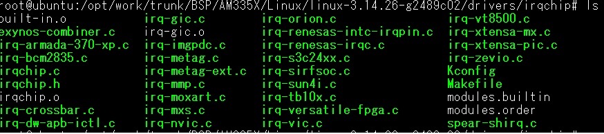

    but, I can't find irq-omap-intc.c
    there is no file (irq-omap-intc.c)
    my kernel version is 3.14.26.
    sdk version is ti-sdk-am335x-evm-08.00.00.00
