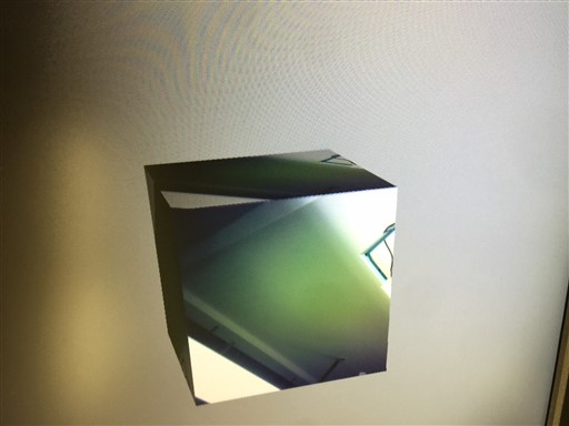

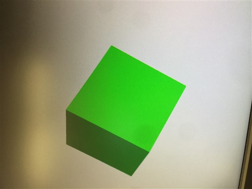

  • Hi - Is there any example code showing how to use DMABUF import to OpenGL on AM57XX?
  • Hi Philip,
    Please refer http://git.ti.com/glsdk/omapdrmtest/blobs/master/util/display-kmscube.c for gbm_bo_import() usage.
    filevpedisplay application be used to test this.
    Filevpedisplay with vpe's output in RGBA format uses gbm_bo_import() and create an RGB texture on kmscube with below command.
    target$ filevpesiplay /usr/share/ti/video/airshow_p352x288.yuv 352 288 nv12 720 480 abgr32 0 0 352 288 0 1 --kmscube --connector 32 --fps 10
    Let me know if you have any issues.
    Ramprasad
    Please PPlease
  • Hi Ramprasad,
    Thank you for the response.
    When I run omapdrmtest, I get the error "get_buffers not supported". Please see below. The EGL extension print shows that the DMABUF import functionality is supported:
    EGL_EXT_image_dma_buf_import
    Any idea what I am doing wrong? Thanks.
    root@fam57xx:/home/flk# ./filevpedisplay framebuff_low_res.yuv 640 480 yuyv 640 480 abgr32 0 0 640 480 0 1 -
    vpe:/dev/video0 open success!!!
    Forcing playback rate at 1 fps.
    Chosen Connector ID = 32
    failed to load module: /usr/lib/gbm/gbm_dri.so: cannot open shared object file: No such file or directory

    After fixing that I see a cube spinning on the HDMI. The remaining problem is that the cube is green most of the time, but for 1 second every 10 seconds it shows my image that I am feeding to it on the command line. I have attached images below. Why is it green most of the time? Thanks.
  • Hi Philip,
    I am not sure how your input to vpe looks like.
    There is a NV12 airshow_p352x288.yuv raw file in /usr/share/ti/video of the root-filesystem.
    Can you please try this command and let me know if you observe proper results?

  • Hi Ram,
    I want to try that file ( airshow_p352x288.yuv ) - but I cannot find it on my Ubuntu dev system,  would you please attach it to this thread so I can download and test?
    I have attached my YUYV file ( framebuff_low_res.yuv ). It is a raw dump of a YUYV frame captured through the VIP at 640x480. Would you please try it on your system with the filevpedisplay application?
    NOTE: I had to rename the attachment from *.yuv to *.123 in order to attach it to this posting.

  • Hi Philips,
    framebuff.yuv has only one frame.
    Please try the attached NV12

  • Hi Ram,
    Thank you for the support it works. I didn't realize the airshow example file contained several frames. Now it looks as expected with my yuv frame.
    I can take it from here as an example.
