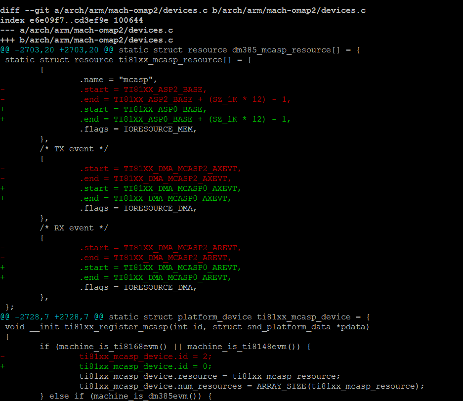

Hi,Ti
I test the TLV320AIC3106(connects to the mcasp0 of dm8148) on my custom board.After modify the kernel(linux-2.6.37 from ezsdk-05.05),the line out is OK,but the mic in and line in do not work.Here are my modification:
Here are the step that I use the mic in to record:
amixer sset 'Right PGA Mixer Mic3L' on
amixer sset 'Right PGA Mixer Mic3R' on
amixer sset 'Left PGA Mixer Mic3L' on
amixer sset 'Left PGA Mixer Mic3R' on
amixer sset 'Right PGA Mixer Line1R' off
amixer sset 'Right PGA Mixer Line1L' off
amixer sset 'Left PGA Mixer Line1R' off
amixer sset 'Left PGA Mixer Line1L' off
#amixer cset name='PCM Playback Volume' 70%,70%
amixer cset name='PGA Capture Volume' 70%,70%
arecord -f cd -r 44100 -d 10 -c 2 mic-test.wav

    I do not see in your modifications changing the McASP data port from McAS2/0x46800000 to McASP0/0x46000000, in devices.c file. This change is pointed in the wiki pages I provided to you and you state that you are align with all the changes there, but I do not see this change!
    Pavel
  • Pavel,
    Sorry,I forgot it.I had changed,but I forgot to paste in here.
    It was in the arch/arm/mach-omap2/board-ti8148evm.c

  • Vefone,
    I see you are attaching the AIC3x codec to I2C3 (bus 4) (addr 0x1B) at your custom board.
    When you run "i2cdetect -r 4", do you detect the codec? At which I2C3 pins you have connected your AIC3x codec? Have you made the pinmux of these I2C3 pins?
    See also:
    processors.wiki.ti.com/.../TI81xx_PSP_Porting_Guide
    Pavel
  • Hi,Pavel
    I solved it.
    The pin configuaration in the ti8148_iis_serializer_direction array is wrong.
    Because the aix3106' 40 pin is connects to dm8148 mcasp0_axr0,and the 41 pin is connects to dm8148 mcasp0_axr3,so the ti8148_iis_serializer_direction should be :
    static u8 ti8148_iis_serializer_direction[] = {
    TX_MODE, INACTIVE_MODE, INACTIVE_MODE, RX_MODE,
    INACTIVE_MODE, INACTIVE_MODE, INACTIVE_MODE, INACTIVE_MODE,
    static struct snd_platform_data ti8148_evm_snd_data = {
    .tx_dma_offset = 0x46000000,
    .rx_dma_offset = 0x46000000,
    .op_mode = DAVINCI_MCASP_IIS_MODE,
    .num_serializer = ARRAY_SIZE(ti8148_iis_serializer_direction),
    .tdm_slots = 2,
    .serial_dir = ti8148_iis_serializer_direction,
    .asp_chan_q = EVENTQ_0,
    .version = MCASP_VERSION_2,
    .txnumevt = 1,
    .rxnumevt = 1,
    BR,
    vefone
