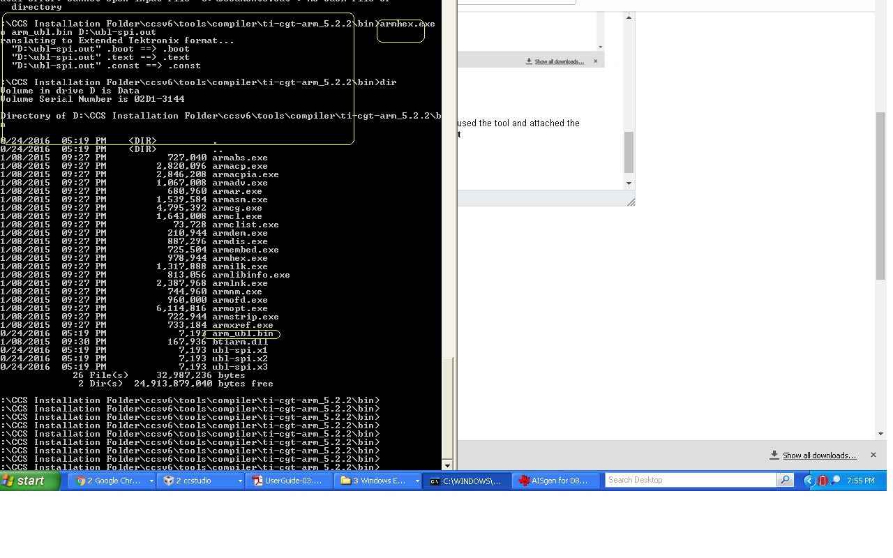

  • If its ARM project, use the following command.
    C:\ti\ccsv6\tools\compiler\ti-cgt-arm_5.2.5\bin\armhex.exe

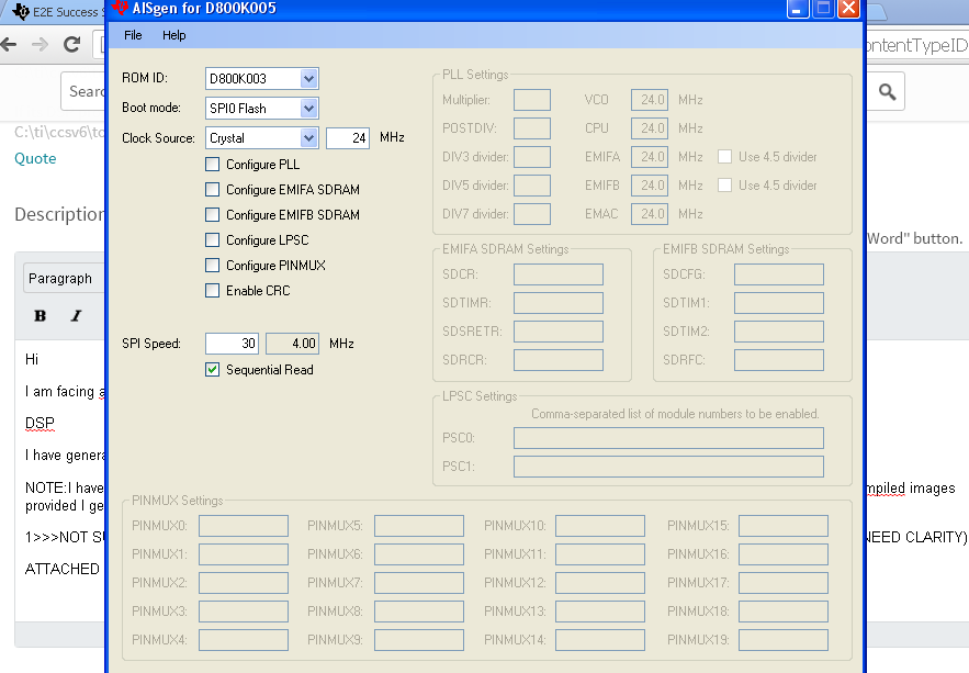

    I am facing a Issue while building .bin files for DSP as well as ARM
    ---------------------------------------------------------DSP SIDE------------------------------------------------------------
    I have generated a .out file from the source code provided and I have fed the .out file to the AIS GEN
    NOTE:I have not configured any values on AIS gen (i,e DEFAULT SETTINGS and I generate a file and when I flash that file with the pre compiled images provided (ARM-UBL, UBOOT) I get the prompt working of U-BOOT  AND THE SIZE OF THE FILE THAT I GENERATE IS SAME AS THE FILE SIZE IN PRE BUILT IMAGES 6K
    1>>>NOT SURE WHY I SHOULD NOT SET ANY PARAMETERS ON AIS GEN( HOPE IS IT THERE IN ARM UBL CODE THAT SETS THIS PARAMETERS ?????????? NEED CLARITY)

    I am really not able to figure out how to generate the binary file for the ARMUBL as specified in the link I have used the tool and attached the reference for what I have executed and tried flashing the ARMUBL in spi writer I dont get the uboot prompt
    Not sure how to generate the UBL.bin for ARM and  the file that is generated  from the command line is JUST 7KB and if i compare with the file that is in pre-built images of ARMUBL is 20kb and when I flash the code of 7 KB the uboot dosent pops up

    I am trying to build the images and  to write that through spiwriter and boot but when i generate the dsp-ubl.bin from the .out out using AIS gen tool if i set any parameters like sdram clock pinmux  and other fields of the gui the bin file generated and will not work when written by spi writer, but if i dont use any fileds and generate .bin as mentioned in the above post and flash the file i get the uboot prompt!
    In  case of ARM I am not sure how to build the the .bin file that is compatible for booting from the .out file
    Need help on generating the images and converting it to .bin in ARM & DSP and test the images by writing from flash writer!
