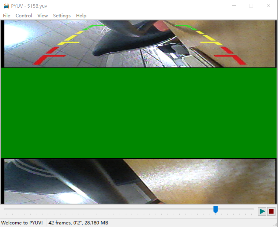

    change the NV12 to YUYV,then I got the video.
    yavta -c60 -p -F/home/root/5158.yuv --skip 0 -t 1/30 -f YUYV -s 720x480 /dev/video1
  • With multiplexed source the NV12 output mode won't work. VIP can accept input source as YUV 422 interleaved or RGB24 format (RAW formats also accepted). VIP internally has scaler, color format conversion, up sampling and down-sampling processing blocks. These processing blocks buffers couple of lines of input captured image for filtering need to do on the fly processing. When VIP input source is multiplexed, these processing blocks (chroma down sampling in your specific case) cannot process on the fly multi-channel input source as they do not have mechanism to line buffer separate channels. Multiplexed captured data is demultiplexed by the Parser and then directly passed to VIP DMA engine named VPDMA for the data to be written to memory as separate channels.
    manisha,thank you! i got it.
