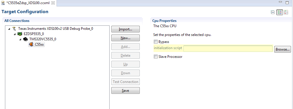

  • Hi Julien,
    You definitely need to initialize the chip with your program instead of relying on the GEL file. One way to test its stand-alone initialization of your program is to run the program from CCS via the USB without loading the GEL file - just delete the path to the GEL file in the highlighted field below in the Target Configuration window. Make sure it runs as expected, at the expected SYSCLK frequency.
    In your initialization, make sure you configure the PLL, reset the peripherals, disable and clear interrupts, set interrupt vectors, open clock gates, and un-idle the DMA M-port (refer to the GEL file).
    For more details on interrupt pointers, refer E2E posts and to 2.8.1 Interrupt Vector Pointers (IVPD, IVPH) of the C55x v3.x CPU Reference Guide - http://www.ti.com/lit/ug/swpu073e/swpu073e.pdf

  • Mark,
    You're right, my problem was the MPORTI bit of the Idle Configuration Register (ICR). I had to activate it in my initialisation. I did it after the idle state but I forgot to do it on start.
    Thank you for your information.
