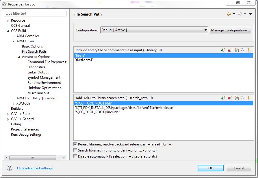

  • Garrett,
       Thank you for the explanation of what the other library's are for and that only one library is needed for the M4 that helps.
    I still do not understand why I cannot call "CSL_xbarIrqConfigure" from my code with the ti.csl.aem4 library added to my project.
    Below is how I included the library into my project are there any other steps I am missing.
  • Charles,
    Do you have the following code in your .cfg file?
    /*use CSL package*/
    var socType           = "am571x";
    var Csl = xdc.loadPackage('ti.csl');
    Csl.Settings.deviceType = socType;
    Above will link ti.csl.aem4 into sysbios.aem4, check the build log:
    generating custom ti.sysbios library makefile ...
        Linking with library ti.board:./lib/idkAM571x/m4/release/ti.board.aem4
        Linking with library ti.drv.i2c:./lib/m4/release/ti.drv.i2c.aem4
        Linking with library ti.drv.uart:./lib/m4/release/ti.drv.uart.aem4
        Linking with library ti.drv.gpio:./lib/m4/release/ti.drv.gpio.aem4
        Linking with library ti.drv.spi:./lib/am571x/m4/release/ti.drv.spi.aem4
        Linking with library ti.csl:./lib/am571x/m4/release/ti.csl.aem4
        Linking with library ti.osal:./lib/tirtos/m4/release/ti.osal.aem4
    Starting build of library sources ...
    making C:/ti/pdk_am57xx_1_0_4/packages/ti/drv/spi/example/qspi_flash/am571x/m4/bios/src/sysbios/sysbios.aem4 ...
    Garrett

    gmake[3]: Leaving directory `C:/ti/PDK_AM~2/packages/ti/csl'
    gmake[2]: Leaving directory `C:/ti/PDK_AM~2/packages/ti/csl'
    gmake lib_allendians CORE=ipu1_0 BUILD_PROFILE_ipu1_0=release
    gmake[2]: Entering directory `C:/ti/PDK_AM~2/packages/ti/csl'
    gmake comp_libs ENDIAN=little
    gmake[3]: Entering directory `C:/ti/PDK_AM~2/packages/ti/csl'
    Nothing to be done for am572x ipu1_0 csl_init
    Nothing to be done for am572x ipu1_0 csl_intc
    gmake -C /ti/PDK_AM~2/packages//ti/csl -fmakefile.mk
    gmake[4]: Entering directory `C:/ti/PDK_AM~2/packages/ti/csl'
    # Compiling am572x:ipu1_0:release:csl: ./soc/am572x/src/csl_device_xbar.c
    C:/ti/ccsv6/tools/compiler/ti-cgt-arm_15.12.1.LTS/bin/armcl -ppd=/ti/PDK_AM~2/packages//ti/binary/ti/csl/obj/am572x/m4/release/.deps/csl_devi
    ce_xbar.P -g -ms -DMAKEFILE_BUILD -c -qq -pdsw225 --endian=little -mv7M4 --float_support=vfplib --abi=eabi -eo.oem4 -ea.sem4 --symdebug:dwarf
    --embed_inline_assembly --emit_warnings_as_errors -ms -oe -O3 -op0 -os --optimize_with_debug --inline_recursion_limit=20 -DBUILD_IPU1_0 -DB
    UILD_IPU1 -DSOC_AM572x -IC:/ti/ccsv6/tools/compiler/ti-cgt-arm_15.12.1.LTS/include -I. -I./soc/am572x/src -I./arch/m4 -Isrc/ip/dcan/V0 -I.
    -Isrc/ip/dcan/V0/V0_0 -I. -Isrc/ip/edma/V1 -I. -Isrc/ip/edma/V0 -I. -Isrc/ip/elm/V0 -I. -Isrc/ip/gpio/V1 -I. -Isrc/ip/gpmc/V1 -I. -Isrc/ip/i
    2c/V2 -Isrc/ip/l3fw/V0 -I. -Isrc/ip/mailbox/V0 -Isrc/ip/mailbox/V0/V0_0 -I. -Isrc/ip/mcasp/V0 -I. -Isrc/ip/mcspi/V0 -I. -Isrc/ip/mmc/V0 -I. -
    Isrc/ip/mmu/dsp/V0 -I. -Isrc/ip/pcie/V1 -I. -Isrc/ip/qspi/V1 -I. -Isrc/ip/spinlock/V0 -I. -Isrc/ip/timer/V1 -I. -Isrc/ip/uart/V1 -I. -Isrc/ip
    /wd_timer/V0 -Isrc/ip/tsc/V0 -Isrc/ip/chip/V0 -Isrc/ip/ecap/V0 -I. -Isrc/ip/ecap/V0 -I/ti/PDK_AM~2/packages/ -I/ti/PDK_AM~2/packages//ti/csl
    -I/ti/PDK_AM~2/packages//ti/csl -fr=/ti/PDK_AM~2/packages//ti/binary/ti/csl/obj/am572x/m4/release -fs=/ti/PDK_AM~2/packages//ti/binary/ti/csl
    /obj/am572x/m4/release -fc ./soc/am572x/src/csl_device_xbar.c
    process_begin: CreateProcess(NULL, C:/ti/ccsv6/tools/compiler/ti-cgt-arm_15.12.1.LTS/bin/armcl -ppd=/ti/PDK_AM~2/packages//ti/binary/ti/csl/o
    bj/am572x/m4/release/.deps/csl_device_xbar.P -g -ms -DMAKEFILE_BUILD -c -qq -pdsw225 --endian=little -mv7M4 --float_support=vfplib --abi=eabi
    -eo.oem4 -ea.sem4 --symdebug:dwarf --embed_inline_assembly --emit_warnings_as_errors -ms -oe -O3 -op0 -os --optimize_with_debug --inline_rec
    ursion_limit=20 -DBUILD_IPU1_0 -DBUILD_IPU1 -DSOC_AM572x -IC:/ti/ccsv6/tools/compiler/ti-cgt-arm_15.12.1.LTS/include -I. -I./soc/am572x/src -
    I./arch/m4 -Isrc/ip/dcan/V0 -I. -Isrc/ip/dcan/V0/V0_0 -I. -Isrc/ip/edma/V1 -I. -Isrc/ip/edma/V0 -I. -Isrc/ip/elm/V0 -I. -Isrc/ip/gpio/V1 -I.
    -Isrc/ip/gpmc/V1 -I. -Isrc/ip/i2c/V2 -Isrc/ip/l3fw/V0 -I. -Isrc/ip/mailbox/V0 -Isrc/ip/mailbox/V0/V0_0 -I. -Isrc/ip/mcasp/V0 -I. -Isrc/ip/mcs
    pi/V0 -I. -Isrc/ip/mmc/V0 -I. -Isrc/ip/mmu/dsp/V0 -I. -Isrc/ip/pcie/V1 -I. -Isrc/ip/qspi/V1 -I. -Isrc/ip/spinlock/V0 -I. -Isrc/ip/timer/V1 -I
    . -Isrc/ip/uart/V1 -I. -Isrc/ip/wd_timer/V0 -Isrc/ip/tsc/V0 -Isrc/ip/chip/V0 -Isrc/ip/ecap/V0 -I. -Isrc/ip/ecap/V0 -I/ti/PDK_AM~2/packages/ -
    I/ti/PDK_AM~2/packages//ti/csl -I/ti/PDK_AM~2/packages//ti/csl -fr=/ti/PDK_AM~2/packages//ti/binary/ti/csl/obj/am572x/m4/release -fs=/ti/PDK_
    AM~2/packages//ti/binary/ti/csl/obj/am572x/m4/release -fc ./soc/am572x/src/csl_device_xbar.c, ...) failed.
    make (e=2): The system cannot find the file specified.
    gmake[4]: *** [/ti/PDK_AM~2/packages//ti/binary/ti/csl/obj/am572x/m4/release/csl_device_xbar.oem4] Error 2
    gmake[4]: Leaving directory `C:/ti/PDK_AM~2/packages/ti/csl'
    gmake[3]: *** [csl] Error 2
    gmake[2]: *** [little_lib] Error 2
    gmake[1]: *** [ipu1_0_lib] Error 2
    gmake[1]: Leaving directory `C:/ti/PDK_AM~2/packages/ti/csl'
    gmake: *** [am572x_lib] Error 2
    I find it very interesting that the error is on the file csl_device_xbar.c which is the file that contains the function CSL_xbarIrqConfigure().
    I have to figure out how to build the pcie example for the m4 next.
  • I got the pcie example to create and build.
    It does compile with the function call to CSL_xbarIrqConfigure().
    I will have to compare project and .cfg file settings to see what I am possibly missing.
    Thank You
