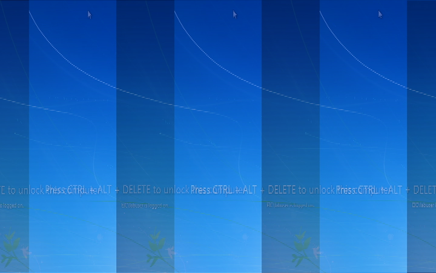

I have used TI816x EVM board to capture 1440x900@60 resolution at VIN0 port , encode it in H264 formate , stream it   and display the same.
All the links are created with 1440x900 resolution properly.
I have added all the changes regarding this resolution in MCFW, DEMOS, HDVPSS and KERNEL directory.
The problem is capture ,encode and display video got shifted.
Capture Video Snapshot
-Regards,
Prabhunath
  • So can anyone tell me how to make proper it ?

  • As you could see, the frame reported on the VIP0 is 1920x1080, whereas the frame size reported on VIP1 is 1920x2003. But you are trying to capture 1440x720 frame size. VIP is receiving this frame size, which includes blanking. So we need to crop addition blanking..
    Brijesh

  • Hi Brijesh,
    Thank you so much for your response.
    I am able to capture proper resolution with minor changes in register given by you.
    Please see below registers value for VIN0 port in various scenario.
    1-> Value before running usecase.
    0x48105530 =  0x00000000
    0x481055C0 = 0x00000000
    0x481055C4 = 0x00000000
    2-> Value After running usecase.
    0x48105530 = 0x07800438
    The demo is running on 1440x900@60 resolution. All the links created with 1440x900 resolution. Capture statistics showing widths and height same (1440x900) resolution. But the value of  0x48105530 register is  still showing (1920x1080) resolution. I don't know the reason behind it. I think the value of 0x48105530 register should be 0x05A00384. if it is then cropping  is not required.(Just assume)
    The capture is not proper so the result is same as previous snapshot.

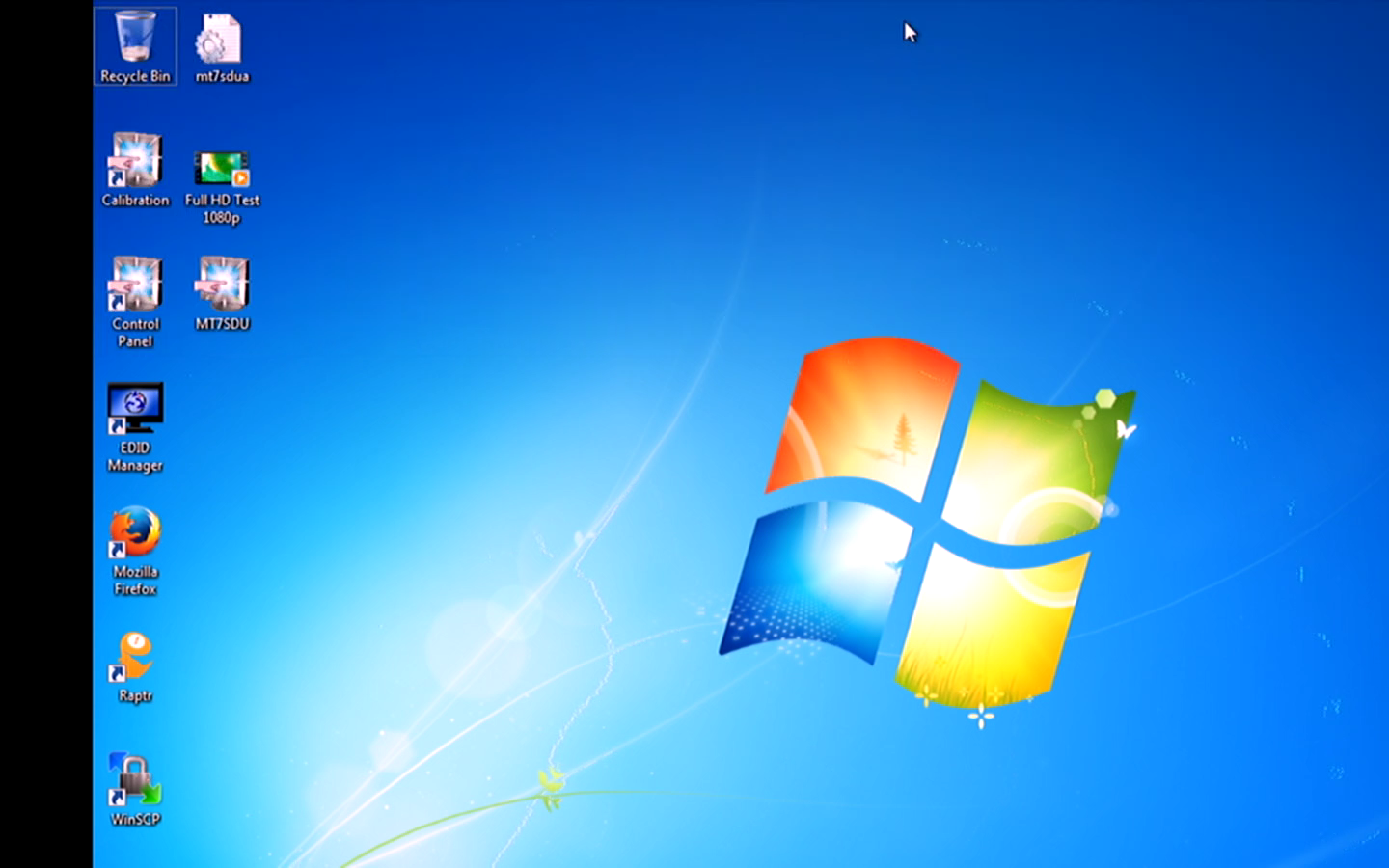

    3-> Demo is running and set below register with crop value.
    devmem2 0x481055c0 w 0x05A080F0
    devmem2 0x481055c4 w 0x0384005E
    Register value after this.
    0x48105530 = 0x05A00384
    0x481055C0 = 0x05A080F0
    0x481055C4 = 0x0384005E
    I didn't change the value of 0x48105530 register but it got changed to 0x05A00384(Now it contain proper value of 1440x900). I don't know why it is changed. One more thing, now the value of 0x48105530 register is showing width and height (1440x900) proper.
    After this setup usecase is working fine.

  • Hi Brijesh,
    Thanks for your reply.
    Yes, you are right.
    WE have backtraced VIP parser crop register (0x481055C0 and 0x481055C4) in HDVPSS driver and found one  ioctl  ("IOCTL_VPS_CAPT_SET_VIP_CROP_CFG" ) to set the same register value.
    So that we have created system link control to configure above ioctl. Now we are able to change the above register using usecase.
    Now we are able to capture 1440x900 resolution successfully.
    Once again thanks for your support.
