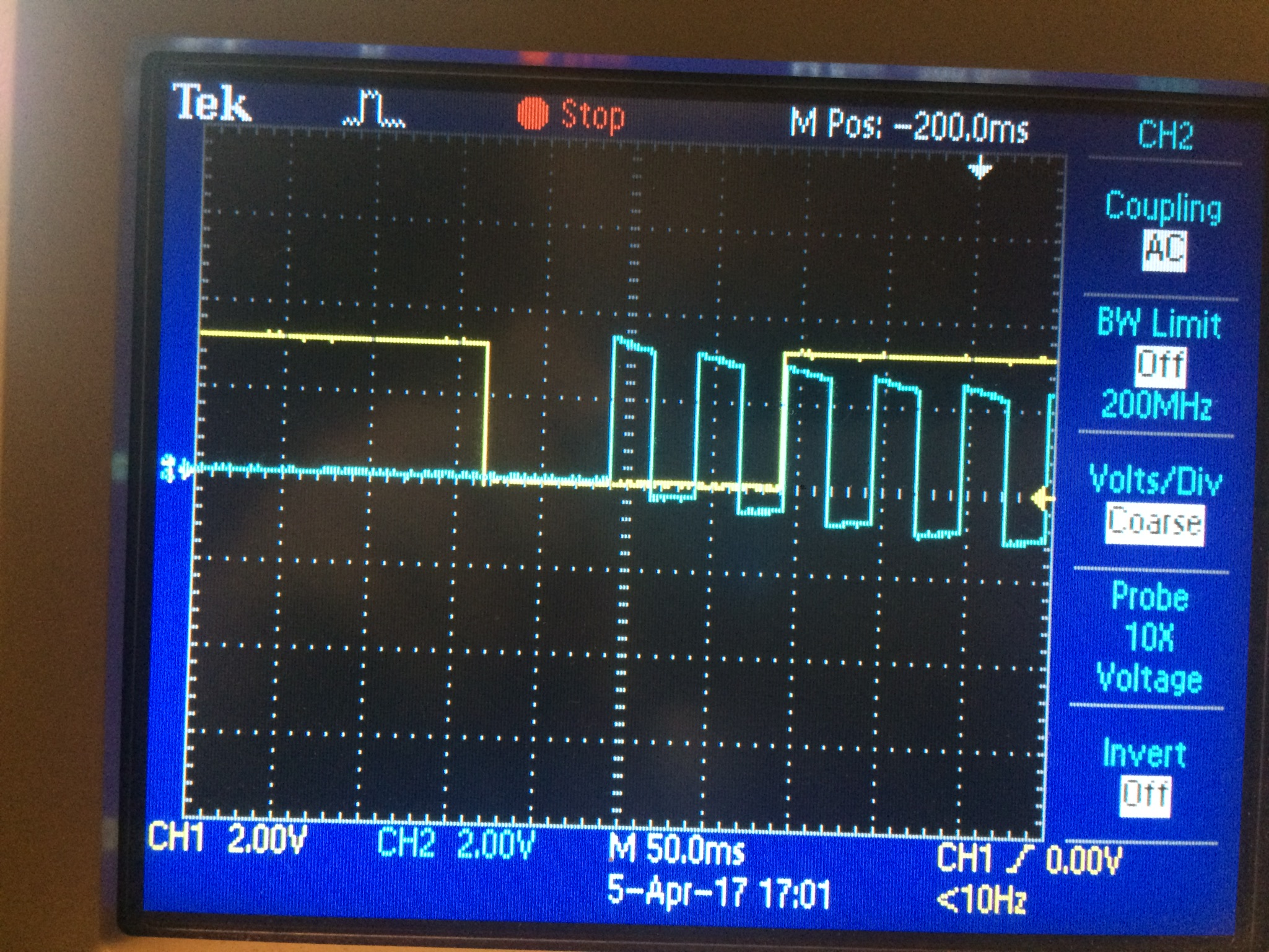

    Just to check, which pad are do trying to toggle for enter/exit sleep? Otherwise, it should work.
  • Thank for your quick reply, But, i think i do not really understand your idea. Do you mean I should use your code block instead of mine: // Config GP0[8] - DEEPSLEEP pin - pin number 9 savePinMux = HWREG(SOC_SYSCFG_0_REGS + SYSCFG0_PINMUX(0)); HWREG(SOC_SYSCFG_0_REGS + SYSCFG0_PINMUX(0)) = PINMUX0_31_28_DEEPSLEEP & savePinMux; // Step 6: Config delay in the SLEEPCOUNT bit (ex: 0x0F) I will test and feedback to you asap. And your question "which part are do trying to toggle for enter/exit sleep?" Do you mean arm or dsp part? I use both parts so I am trying controller all of them to deepsleep then exit this mode. Thank again, Nghia Quy
  • Sorry, my eyes missed the first zero in definition of PINMUX0_31_28_DEEPSLEEP. That would indeed mean field PINMUX0_31_28 is set to zero.
    The PAD number is F4 which is multiplexed RTC_ALARM/GP0[8]/UART2_CTS/DEEPSLEEP. On the LCDK, this pad is not connected. I assume that you are using a custom board and that you have not used the pad for one of the other functions. Documentation says the DEEPSLEEP pin is normally high, active low.
  • Hi Norman,
    I am using a custom board and I only use F4 pin for Deepsleep function.
    Normally, this pin is high, it only changes to low status when setting DeepSleep.
    I really do not understand why the program do not exit the while loop. The configuration is so clear and logical.
    When you used C6748, did you use JTAG for debug?
    I am using JTAG, but the board can not keep the connection to CCS right after Deepsleep pin being low. So I can not debug the status of board after into deepsleep mode (even then the deepsleep pin changed to high level).
    Did you miss the issue like me?
    Thank you,
    Nghia Quy

    Today, I try to test a sample code to check DEEPSLEEP functions.
    My hardware includes:
    • A button connected to DEEPSLEEP pin (GP0[8]), it is high default.
    • A pin GP6[14] is output pin to debug
    My software process is:
    • I press the button to enable DEEPSLEEP mode, then I release for waking up and put an pulse continuously in GP6[14]
    • If the program wakes up from DEEPSLEEP mode, it will have a square pulse in GP6[14] pin.
    And the result is:
    1. Most of times, the program did not wake up from DEEPSLEEP mode
    2. In sometimes, if I pressed then released really fast the button, the program will wake up and having a pulse in GP6[14]
    3. But I viewed on oscilloscope then I saw that having a pulse in GP6[14] (blue line) before the level of DEEPSLEEP pin changing from low to high (yellow line). It means the program waked up before DEEPSLEEP pin changing from low to high. According the theory, it is not possible.
    Anyone can help me understand this results?

  • Some comments, assuming DeepSleepTest.c is the complete test code:
    1) You can move the pinmux of DEEPSLEEP pin out of the loop.
    2) Your code DeepSleepTest.c does not have any PLL shutdown and restart. I believe you have to have that at a minimum. The deepsleep signal will gate the clock and the PLL will lose its reference clock. From what I have seen on the forum, the processor does not like a jittery PLL and tend to lock up. That might be what is happenning when your processor enters deepsleep. This is where commenting out your SLEEPCOMPLETE loop is a goot test of the PLL shutdown and restart without going into deepsleep. Same for DDR stop/start and any other PSC stop/start code.
    3) The apparent waking before the deepsleep signal is deasserted may be due to bounce on your switch. It is deasserting ever so briefly immediately after press the button. You might need to add a debounce resisitor/capacitor of some kind. I'm firmware and can't recommend a values or schematic.
    Finally, I can do deepsleep mode in OMAP.
    You were right, in my code DeepSleepTest.c, I have to add PLL shutdown and restart.
    Thank Norman and Mukul Bhatnagar so much for your helps,
    Quy Nguyen
