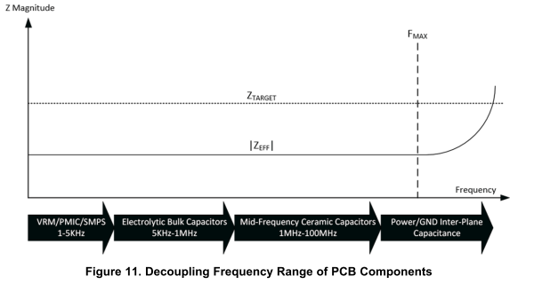

Hello, we are designing AM5716 board.
Regarding Sitara™ Processor Power Distribution Networks:Implementation and Analysis(sprac76.pdf)
(www.ti.com/.../sprac76.pdf), we need FMAX and ZTARGET values to design our board.
Could you please tell FMAX and ZTARGET values for AM5716?
FMAX: Please see P9 of sprac76.pdf.
ZTARGET is mentioned to the following P12.
I can not find ZTARGET value on AM5716 Datasheet.
In order to know the ZTARGET, what should I look for in the AM 5716 data sheet?
