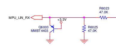

I have some issues with UART2 and can't seem to find a solution. Transmission works perfectly. I get the 1.3 msec break using a lower baud rate.
All scope signals look good, the timings are identical to the ones I have with our gauges with an old Jujitsu processor. I am able to get the slave gauges working as well as warning lights.
The problem arises with the input modules or whenever I send messages that require a response from the gauges or input modules.
The signals are OK on the scope both at LIN_OUT and MPU_LIN_RX but I get no signal at the uart RX line.
If I change to use GPIO instead of UART pins I am able to toggle the TX and read the status on the RX Line.
I tried both blocking and non blocking modes, with select and without select.
I also tried a regular uart program and command line access with echo and cat, I cannot read anything from UART2
I have no issue with UART1 or UART3. I haven't tried UART9 yet.
I provided the schematic to Nicolas Le Lan (France). ACTIA's home base is ACTIA Automotive in France. ACTIA Corp is in Indiana but our TI contacts are those of ACTIA Automotive.
The circuits does the correct voltage conversion from 3.3V to 7.6V which is the voltage used by our gauges and warning modules.

  • Hi Michel,
    Am I understanding correct? You can measure a data incoming on the processor RX pin, but UART2 is not firing any interrupt? How much data is expected in one data frame?
    regards,
    Stan

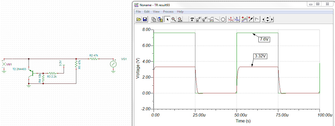

    It is a LIN circuitry so the TX is fed back to the RX. There is level translation since our supply on the gauge is 7.6V. The output is inverted twice, the input is not inverted, just kept from exceeding 3.3V
    The signal appears exactly as expected at the processor pin, from zero to 3.3V. The gauge always responds.
    I have tried several ways for the dts, at first I had the uart2 same as uart1. uart1 is used to program ans STM32 using ST bootloader. I then added some extra stuff like I had for uart3 which is used for the serial debug.
    That didn't change anything.
    The signal fed to that circuit is the LIN Signal which varies between 0 and 7.6V

  • That is the input, the signal fed can vary between 0 and 7.6V
    Michel
  • Hi Michel,
    What is the logic 1 voltage measured on MPU_LIN_RX?  I don't think the PNP does it's mission to regulate at 3.3V. Bipolar transistors need -0.6V VEB to start conducting current. I.e. the transistor on the diagram does nothing up to 3.9V. Although 7.6V / 2 = 3.8V, because of the divider network, it is still bad for the processor pins.
  • Michel,
    We did a little simulation here. As you see the pnp is regulating at 3.3V only after we've added R3/R4 divider for a 2.75V base voltage.
    Without that network, all 3.8 volts were output.
    This might not solve your problem, but it is a major error of the design.
    Stan
  • Stan,
    Thank you, I will be passing this along with to our electronic design team.
    Michel
