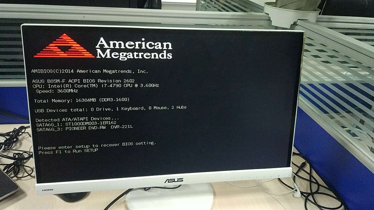

    Just like my earlier post,when the windows BIOS begin.the LTSSM_EN will be clear to 0,even thought i use devmem2 to set this bit.the LTSSM_EN is 0,the link is never up.
    My PC PCIe slot do not support hot-plug,so I can't sure the am5728-evm(EP) will power up before the PC(RC) .
    But I found something wired.when the PC is hung at "CMOS BIOS",the link is up,and the windows system will detect the am5728-evm.
    I am not so familiar with PC,I don't know what is different.
    BTW,I am no need to modify the hardware for detection.am5728-evm use the asynchronous clock.but I am not sure if it will affect the communication.

  • HI,
    Yes, i fix the code 12 error.
    different from dm8168/dm8148 pcie boot. am5728 finish the pcie init at kernel,which is too late.
    If you use win7,the bios can't detect the pcie as ep,and bios will not give it resources, which calls code 12.
    try win10,win10 will give it resources at os system.but I still meet code 10(the driver can not start).
    I think it is because the driver can not enable the memory space enable bit,although the interrupt is  wake up.
