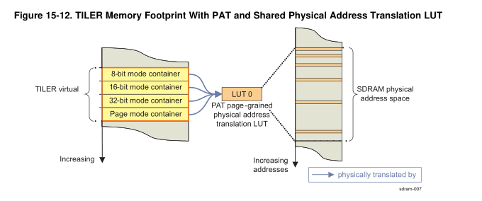

Now we have 2 questions:
1 I want to know where is the tiler memory' start address, even though we know the Tiler Memory is 128MB
2 what's the size of the A15 Linux Kernel.

  • Hi xixi,
    1. The start address is 0x60000000. There is also private memory view for DSS only with start address of 0x01_0000_0000.
    Refer to AM572x TRM, sections:
    2.2 L3_MAIN Memory Map
    2.9 TILER View Memory Map
    See also below pointers:
    e2e.ti.com/.../2248423
    {PSDK}/example-applications/big-data-ipc-demo-linux-01.01.00.00/host_linux/simple_buffer_example/shared/DRA7XX/rsc_table_dsp.h
    {PSDK}/linux-devkit/sysroots/armv7ahf-neon-linux-gnueabi/usr/share/ti/ti-ipc-tree/packages/ti/ipc/remoteproc/rsc_table_vayu_dsp.h
    2. The kernel size depends on what you have include/exclude in it. The default (pre-built) size of the kernel that comes with the PSDK package is 3.7MB
    {PSDK}/board-support/prebuilt-images/zImage-am57xx-evm.bin

  • HI Pavel
    Thanks for your reply.
    Now I'm still confused about the tiler memory.
    As we know the AM5728_evm have 2GB DDR3, the address is start at 0x8000 0000, the end is at 0xFFFF FFFF, the size is 2GB.
    The  tiler region start address is 0x60000000.
    So I am confusing about How to map the DDR3 memory to the tiler region。
    Because we know the 0x6000 0000 is memory hole which need maped to the DDR3 memory and what is the start of the DDR3 memory.
    anther question is
    what's the size of the A15 Linux Kernel CMA region and how to increse the Linux kernel CMA region.
    regards
    Please explore the simple_buffer_example code, it might give you some hints.
    /sys/kernel/debug/dri/ contains debugfs files for the DRM. It can be used to see the framebuffers allocated, the connectors, information about tiler.
    http://processors.wiki.ti.com/index.php/Linux_Core_DSS_User's_Guide

  • HI
    As I said earlier
    The 0x6000 0000 is memory hole which need maped to the DDR3 memory.
    Just now we found the datasheet (spruhz6h.pdf 3315 page)like below:
    The Tiler memory from 0x6000 0000 must translated to the SDRAM.
    So we want to know which SDRAM is maped and what 's the begin of the SDRAM
    Thanks regards
  • HI ALL:
    Anyone can help us about this issue.
    We just want to know what the corresponding relationship is between the Tiler memory and the DDR3 memory.
    regards
  • HI all:
    Anyone else know about how to map the DDR3 memory to the Tiler memory?
    regards
  • HI all:
    According to the documents which you give us.
    We have changed the tisdk_am57xx-evm-rt_defconfig.
    CONFIG_CMA_SIZE_MBYTES=48
    So whether the above methods can increase the Linux CMA memory.
    Even though you have give us so much documents.
    But there is no documents to describe the Tiler Memory mapping.
    So we are so confusing how to map the DDR3 memory to the Tiler memory like below?
    regards
