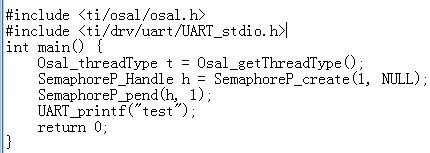

    To build a Cortex-A15 SYSBIOS project in which at least calls once to runtime interfaces implemented by module 'ti.drv.uart', the linker complains about the undefined reference to the functions that are defined in module 'ti.osal' whose library is already included.
Problem Details:
  • main.c:(Note that I only listed the essential part of codes, as I only concern about the linking problem so the runtime validation or initialization is omitted.)

  • At linking stage of CCS project, the linker complains that "undefined reference to Osal_getThreadType", "undefined reference to SemaphoreP_pend" and "undefined reference to SemaphoreP_post".

Manually adding some function call, and make main.c look like this:
After adding some calls to the 'undefined' osal interfaces, the linking problem is gone. Please note that the added codes don't have any runtime logic, it just provide a way to prove the problem is definitely a linking problem.

  • Hi, I am still editing my post. I am having some problem when posting with codes pasted inside.
    I had to take screenshots for the codes, or the post cannot be successfully edited, which is very strange.
