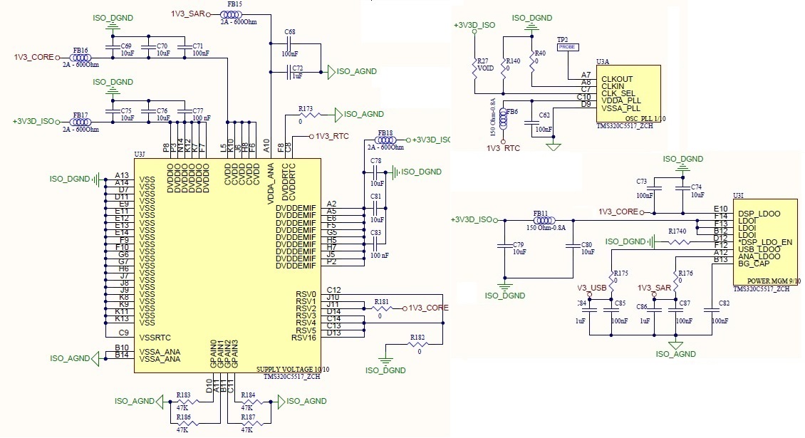

Hello everybody,
we developed a board TMS320C5517 provided with 1,3V core and 3.3V I/O.
DSP power related schematics are attached.
We have a problem related to DSP LDO outputs (1V3_USB,1V3_SAR,1V3_CORE),
which on certain circustances simultaneously drop from the nominal level of 1,3V to about 1,0 V or less,
which is largely under specifications, and we believe could spoil the DSP.
First of all, in general what this voltage drop could mean ?
Which feature of the board could effect this internally generated voltages ?

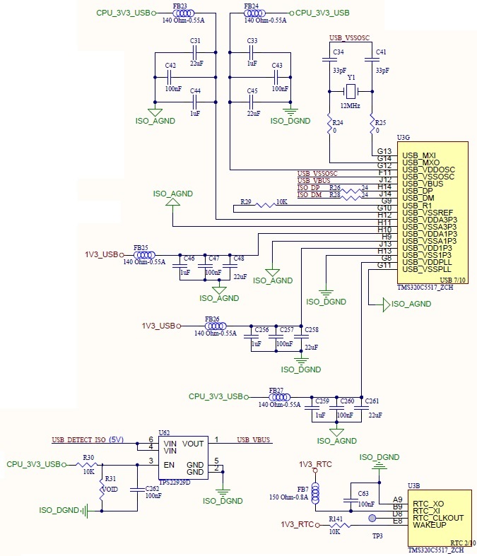

I also tried to exclude USB influence by removing R175, with no better results.

  • Hi Stefano,
    This is a strange issue. All of the symptoms point to an over-current situation, but you say the voltages and currents are within the normal range. Have you checked the main power supply? Is it USB powered? Powered by a wall wort?
    How fast are you measuring the instantaneous current inrush when the ADCs start up? Maybe they need a bigger bulk capacitor.
    Does the C5517 ever go into RESET and reboot?
    When DSP_LDO is used the internal POR reset logic gets enabled, and monitors the DSP_LDO voltage. Reset is applied whenever DSP_LDO < 1V or so.
    What is SYSCLK frequency? For SYSCLK > 175MHz, 1.4V CVDD is required. The on-chip DSP_LDO is not capable of supplying 1.4V.
    What is DSP_LDO_V value in LDOCNTL?
    Try to isolate if one of the LDO outputs is the source of the voltage droop. Supply each LDO externally one by one. For example - supply 1.3V to CVDD and leave DSP_LDOO floating and repeat the experiment.
    If its not a power issue, then next guess is that noise is coupling in somewhere. Maybe noise on the supply or an coupling in from one of those ADC clocks. Perhaps you could try to change CLKIN to high and supply a 12MHz clock at CLKIN as an experiment.
    Do you have two TPS22929 gates for USB power sequencing - one from USB 1.3V to USB_3V3 and another (U62) from USB_3V3 to VBUS? What happens when the USB_LDO droops to 1V? Does it fall below the threshold, and then gate USB_3V3, which would stop the USB oscillator?
    I also wonder what would happen if you clocked the RTC oscillator, if that is possible. There are some power-related registers in the RTC domain...
    Please let us know what you find.
    Mark

    Where were you probing 1V3_RTC? I am interested to see it at C62, right by VDDA_PLL. It sounds like it will be stable, however...
