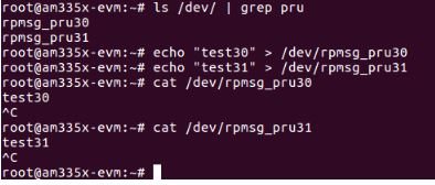

Hi every one my name is Jaime,
I'm sorry form my English. I'm trying to use the rpmsg for me bbb project. I'm follow this manual:
http://processors.wiki.ti.com/index.php/RPMsg_Quick_Start_Guide
 I install de remote proc drivers and when the kernel detect it.  at this point all its ok but when I try to list in my "/dev/"
the elements of rpmsg_30 and rpmsg_31 never it's showed and I can't go ahead.
this is the capture of the elements of dev if all was good.
What is the problem, maybe in my kernel? I don't know what is the problem.
sorry for me English again.
Jaime

  • Hello Jaime & Mike,
    I'll try to help both of you. If it gets too cluttered, Mike can start a new thread and reference this one.
    Jaime,
    What is your kernel and where are you getting it from? Make sure you are using a TI-provided kernel, because remoteproc functionality hasn't made its way to the mainline kernel quite yet.
    Mike,
    1) Same thing as Jaime. Make sure it's a TI-provided kernel ( 4.9.59-ga75d8e9305 is from TI, as long as you didn't add any patches to it)
    2) What board are you using?
    3) I have verified the quick start guide example works on BeagleBone Black with the prebuilt image in Linux Processor SDK 4.2. Can you get it working with the prebuilt image?
    Nick
  • Hey Nick & Jaime,
    So, I believe I found what I was doing wrong.  After finding a very similar thread:https://e2e.ti.com/support/arm/sitara_arm/f/791/p/493697/1785463#pi316653=2
    I was originally using the PRU Software Support Package v4.0.2.  There is a very subtle difference in the example PRU_RPMsg_Echo_Interrupt1 in that the PRU SW Support version appears to be using mailboxes while the Linux SDK v4.02.00.09 is using system events.  I didn't change anything else in my system other then putting the SDK PRU_RPMsg_Echo_Interrupt1.out in the /lib/firmware folder, echoing to remoteproc2, and I started seeing the 100 'hello world' response messages expected in the example program.
    Now, I still do not have any rpmsg_pru* in my /dev/ folder, but I think when using System Events this is no longer necessary.
    FYI, I am using a BeagleBone Black for this testing and have been bouncing back and forth between the TI Linux SDK & Yocto/Poky with the meta-ti layer.  One thing that really through me off is the hands on lab and the http://processors.wiki.ti.com/index.php/RPMsg_Quick_Start_Guide are out of date and stale in this regard.  They mention needing the /dev/rpmsg-pru* devices when that is for older version of the linux kernel.
    Anyways, hope this helps and I will update if I learn anything further.
    -Mike T

  • Hello Mike,
    I misspoke earlier:
    There are multiple ways to access the PRU channel created for RPMsg communication. There is a kernel-space driver, which is used in part 1 of Lab 5 of the PRU Hands-on Labs. You are correct that this driver does NOT use /dev/rpmsg-pru.
    /dev/rpmsg-pru* allows a user space character driver to communicate with the PRU, as in part 2 of Lab 5 and the RPMsg Quick Start Guide. So if you don't follow the steps listed in those pages, you wouldn't see /dev/rpmsg-pru*.
    Glad the system events/mailboxes was cleared up. The original poster seems to have disappeared, so I'm marking this thread resolved.
    Nick
