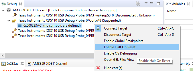

    If the issue is happening during power transition modes that cause the device to reset, all breakpoints are cleared and you will not be able to halt at the exceptions. You can, however, trap the core at reset by enabling the Halt on Reset feature. With the device connected, go to the Debug view and select the option below:
