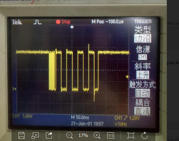

  • Hello
    I scope the MDC, during kernel starting up, the MDC signal only keeping amoment, and then keep high. But when I change the kernel to linux3.2, during starting up, the MDC signal is always present.
  • continue:
    The reason of MDC signal only keep amoument is that PHY Acknowledge Status Register is 0, and in davinci_mdio_reset function, data->bus->phy_mask will be 0, then, in __mdiobus_register function fllow code will only exuted one time:
    for (i = 0; i < PHY_MAX_ADDR; i++) {
    if ((bus->phy_mask & (1 << i)) == 0) { //phy_mask=0,here will be true
    struct phy_device *phydev;
    phydev = mdiobus_scan(bus, i); //use mdio read phy, but return error
    if (IS_ERR(phydev) && (PTR_ERR(phydev) != -ENODEV)) {
    err = PTR_ERR(phydev);
    goto error; // go out
    so when I scope the MDC, I got amoment MDC signal.
    I try to modify the code like this:
    // goto error;
    so the code will scan all 32 phy id, and print MDIO User Access Register 0, I got 0x40ffff~0x5fffff, it means the phy chip not acknowledged(MDIO User Access Register 0 bit 29 ACK=0).
    I scope MDC and MDIO at the same time, I can scope all of the signals, is this means the mdio bus has worked?
