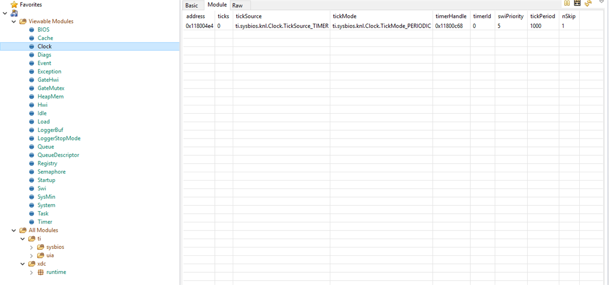

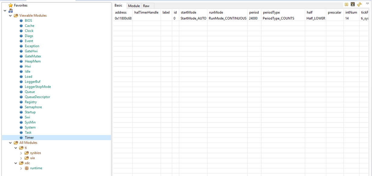

I'm confused about the hal timer, versus the clock module.  I've attached two pictures from the sys-bios ROV, one showing the Timer configuration, and the Clock configuration.  Couple questions:
1) why is the period of the hal timer 24000.  My cpu osc is 336,000,000.  That would give a tick rate of 71.4 uS?
2) Both the hal and clock timers are ID 0.  Is that right?
3) I've set the clock period to 1000.  That is 1 ms?
4) Is there anyway to get the hal timer and clock handles, so I can make calls querying their values
5) when I make a call to xdc_runtime_Timestamp_get32(), is it using the clock or hal timer.  And are the counts from that call of ( 1 / 336,000,000) in increments?
6) do I really need to use the clock, when the hal timer is already there?

  • 1. BIOS assumes some default CPU rate for your device based on some TI EVM board. If your running at a different frequency you need to let BIOS know that your CPU is running at 336 Mhz.

    2. Clock uses Timer as its source. What you picture above is not the "Hal" Timer. Its the actual Timer on your device and its being use to drive clock.
    3. Yes, 1000 for the clock period means 1 ms.
    4. You did not create an instance of Clock so there is no handle to get. You configured just the module properties. There are Clock module functions that you can call. See the SYSBIOS cdoc documentation for a list of APIs you can call. The particular Timer instance you see was internally created so you cannot get the handle to that Timer instance.

  • Even though I didn't create an instance, there is a Clock active on my system (based off Timer 0)?  It is always there, regardless whether I create an instance of Clock?  Or do I need to create an instance, for there to be a Clock?
    That is correct,  BIOS has clock enabled by default.  You can disable it but most systems running an RTOS need timing.

    Been trying to figure out the 24000 period for the Timer (This is a 10 year old chip so had to find some old docs).
    I think I finally understand it but its very possible it is not correct for your setup.
    The frequency for Timer 0 and 1 are not tied to your CPU frequency for these devices.  They are tied to the AUXCLK.
    The AUXCLK is derived from the OSCIN which is the frequency of the crystal oscillator (internal or external depending on CLKMODE bit in PLLCTL).
    BIOS is setting this to a default value of 24Mhz (probably because there was a device with this as the default) that's why you see the 24000 in the period for the Timer.
    If you know what your OSCIN value is, you can hack a BIOS file to make it right for your device.
    In your BIOS installation, edit:  packages/ti/sysbios/timers/timer64/Timer.xs
    Search for a device called "DA850"
    Modify the intFreq.lo field

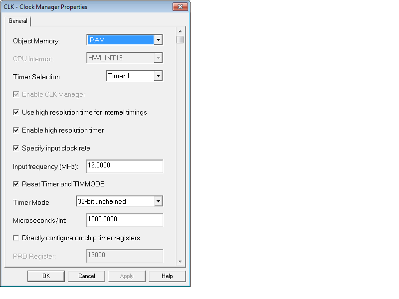

  • judahvang said:
    On The C6x, the timestamp is a special counter dedicated just for this purpose.  It isn't one of the general purpose timers 0, 1, 2, etc...
    That runs counter to my experience with DSP-BIOS.  There you had to indicate which timer is used for the OS clock, as shown in the pic below.  Has SYS-BIOS somehow changed that?

    Thanks for that info.  Here's a thread showing an alternative method in the .cfg file, to do same thing.  Guy initiating the thread, though, wasn't real happy that information is not apparent to the user, who might be using a different OSC than the default 24 Mhz, as am I (16 Mhz).  I can see why, since it took a while for me to discover that as well.  And that thread was 5 years ago ;)
    var Timer = xdc.useModule('ti.sysbios.timers.timer64.Timer');
    Timer.intFreqs[Timer_Id].lo = 1600000;
    Timer.intFreqs[Timer_Id].hi = 0;

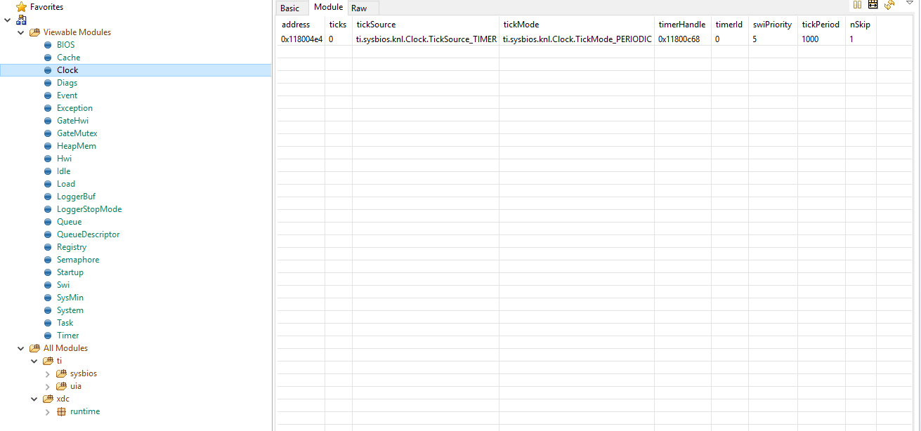

  • The ROV view that you posted earlier in this thread confirmed it for me. Your Clock Manager was enabled and a created a Timer (see the Timer handle field) which matches the Timer instance.
    1. DSP-BIOS did not have a "Timer" module but internally the CLK module programmed up a Timer and hooked it to an HWI interrupt. We allowed you some basic Timer configuration via the CLK Manager properties. This is what your picture shows. So DSP-BIOS still automatically creates a default Timer to drive the Clock.
