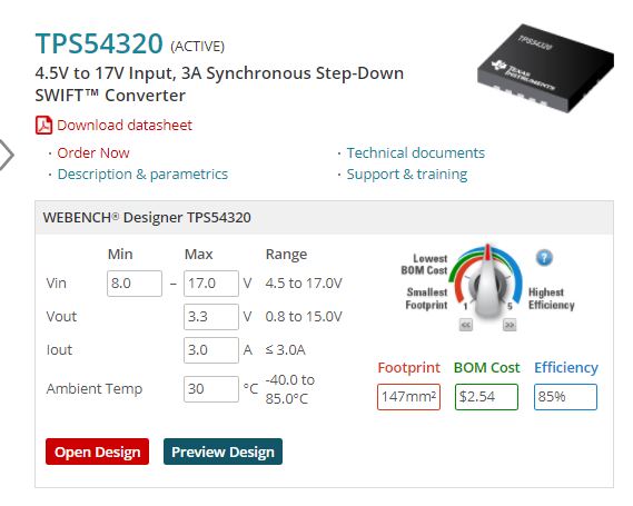

  • Hi Tom,
    Thanks for your response.
    It seemed it is hard to modify feedback resistors of LMZ31704, and thus my customer is considering LM10011 + TPS54320 combination.
    But, they found the minimum output voltage of TPS54320 is +0.8V although C6655 requiring ~0.7V ~ +1.1V.
    Is it possible to use LM10011 + TPS54320 to C6655?
    from TI web, I found below.
    My customer's design and calculations are
    lm10011 design.pdf
    Thanks and Best Regards,
    SI.
  • SI,
    I am concerned about the 0.8V reference in the TPS54320.  The product page for the TPS54320 points you to the newer TPS54424.  The TPS54424 is in the same size package and it operates with a 0.6V reference same as we used on our reference designs with the LM10011.  I recommend that the customer uses a power converter with a 0.6V reference.
    The analysis looks good.  Once it is redone for the TPS54424, I expect the design will be ready to approve.
