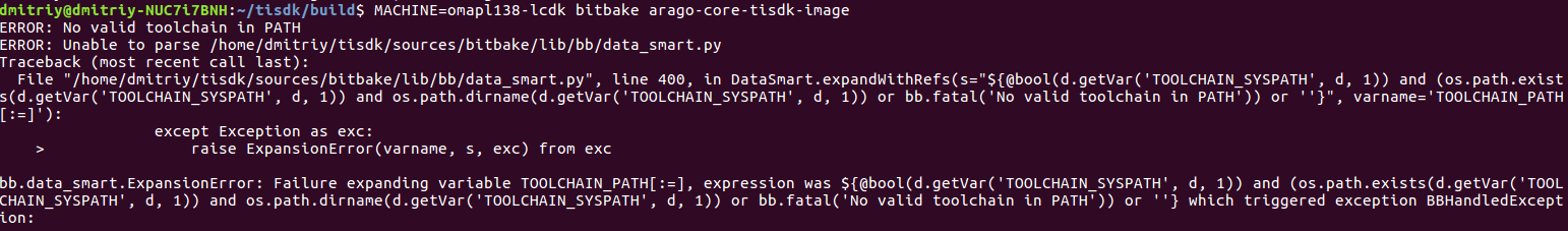

I own the OMAPL138-LCDK and wanted to build the SDK from scratch following these: tutorials.
My overall goal is to able to update my version of the kernel to 4.14 which the latest TI-Linux, since the the 4.9 kernel provided with the pre-built SDK doesn't have the UAC1 USB Audio modifications.
When I get to running "MACHINE=omapl138-lcdk bitbake arago-core-tisdk-image" it will throw the Machine selected isn't supported under the Linaro toolchain that's "gnueabihf."
"MACHINE=omapl138-lcdk bitbake arago-core-tisdk-image" starts to build and compile if I use Linaro toolchain with "gnueabi", however I receive 3 errors during the process in which it ends up terminating later.
This post has the same problems and identical build errors related to "zlib-1.2.8-r0 do_configure: Function failed: " and other libraries.
I then tried using the arago-toolchain instead of Linaro but when I add the arago-toolchain to the path, the "MACHINE=omapl138-lcdk bitbake arago-core-tisdk-image" commands fails saying there is no valid toolchain found in the path.
So I'm stuck, because I really need to update the Linux Kernel in order to utilize the latest patch UAC1 patch it contains.

  • This is the result of bitbake command:
    dmitriy@dmitriy-NUC7i7BNH:~/tisdk/build$ MACHINE=omapl138-lcdk bitbake arago-core-tisdk-image

    WARNING: xz-native-5.2.2-r0 do_fetch: Failed to fetch URL tukaani.org/.../xz-5.2.2.tar.gz, attempting MIRRORS if available
    WARNING: libmpc-native-1.0.3-r0 do_fetch: Failed to fetch URL www.multiprecision.org/.../mpc-1.0.3.tar.gz, attempting MIRRORS if available
    WARNING: libpcre-native-8.39-r0 do_fetch: Checksum mismatch for local file /home/dmitriy/tisdk/downloads/pcre-8.39.tar.bz2
    Cleaning and trying again.
    WARNING: libpcre-native-8.39-r0 do_fetch: Renaming /home/dmitriy/tisdk/downloads/pcre-8.39.tar.bz2 to /home/dmitriy/tisdk/downloads/pcre-8.39.tar.bz2_bad-checksum_635f8e27fc14962e6e3da7efca5a46f9
    WARNING: libpcre-native-8.39-r0 do_fetch: Checksum failure encountered with download of downloads.sourceforge.net/.../pcre-8.39.tar.bz2 - will attempt other sources if available
    ERROR: libtool-cross-2.4.6-r0 do_configure: configure failed
    ERROR: libtool-cross-2.4.6-r0 do_configure: Function failed: do_configure (log file is located at /home/dmitriy/tisdk/build/arago-tmp-external-linaro-toolchain/work/armv5e-linux-gnueabi/libtool-cross/2.4.6-r0/temp/log.do_configure.9058)
    ERROR: Logfile of failure stored in: /home/dmitriy/tisdk/build/arago-tmp-external-linaro-toolchain/work/armv5e-linux-gnueabi/libtool-cross/2.4.6-r0/temp/log.do_configure.9058

    | checking for arm-linux-gnueabi-gcc... arm-linux-gnueabi-gcc -march=armv5e -marm --sysroot=/home/dmitriy/tisdk/build/arago-tmp-external-linaro-toolchain/sysroots/omapl138-lcdk
    | checking whether the C compiler works... no
    | configure: error: in `/home/dmitriy/tisdk/build/arago-tmp-external-linaro-toolchain/work/armv5e-linux-gnueabi/libtool-cross/2.4.6-r0/build':
    | configure: error: C compiler cannot create executables

    Can you try to install the following 32bit libraries:
    processors.wiki.ti.com/.../Sitara_Linux_SDK_64_Bit_Ubuntu_Support
    And try your build again.
    If it continues to fail try the following:
    MACHINE=omapl138-lcdk bitbake -c cleanall libtool
    MACHINE=omapl138-lcdk bitbake libtool

    After installing the 32-bit libraries and trying to build again, libtool failed again.
    After performing cleanall on libtool and bitbaking it then trying the full build again, libtool failed again.
    These are the outputs:
    dmitriy@dmitriy-NUC7i7BNH:~/tisdk/build$ MACHINE=omapl138-lcdk bitbake libtool

    It says the C compiler doesn't work
    Check again the toolchain you use. It should be:
    gcc-linaro-6.2.1-2016.11-x86_64_arm-linux-gnueabihf
    Also what is the OS on your host (I recommend ubuntu 16.04)? make sure you installed:
    sudo apt-get install git build-essential python diffstat texinfo gawk chrpath dos2unix wget unzip socat doxygen libc6:i386 libncurses5:i386 libstdc++6:i386 libz1:i386
    Try updating the path to the cross compiler prior to building the arago-project file system:
    PATH=$HOME/gcc-6.2.1-2016.11-x86_64_arm-linux-gnueabihf/bin:$PATH
    Yordan
  • Hi, I do have Ubuntu 16.04 LTS, and I have installed those packages prior.
    I have used that to update the PATH before I run bitbake everytime including . conf/setenv
    This is the result using the "gnueabihf" instead of the "gnueabi"
    Sorry, it should be gnueabi.. I made a typo.
    Maybe you need an updated toolchain with the latest kernel 4.14...
    I am not sure why this is not working... let me check with the yocto team.
    Yordan
    So this one isn't even the update kernel, this is still 4.9
    If this worked then I would go on to try 4.14.
    Thank you for checking it for me.
