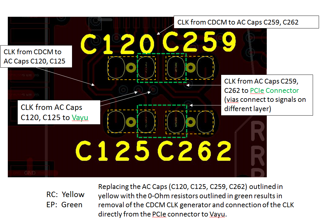

  • In the bellow mentioned scenarios we use the PCIe cable modification as suggested on your wiki page:
    processors.wiki.ti.com/.../Linux_Core_PCIe_EP_User's_Guide
    We use x1 PCIe cable.

  • Hi Stefan,
    It does look like an issue with the reference clock supplied to the EP. To ensure that the PC provides the reference clock to the EP (over PCIe), please modify the following (on the TDA2XX EVM):
    1. Populate the reference clock signal on the cable
    2. Depopulate capacitors C120/C125/C259/C262
    3. Populate 0-ohm resistors across C120/C259 and C125/C262 (shown in the fig)
    4. Depopulate resistors R806/R807
    5. Resistor R223
         i) Populate with 100ohm if PCIE Connector clock is LVDS
         ii) Depopulate if PCIE Connector clock is HCSL
    Also in the device-tree file dra7xx-clocks.dtsi, modify the reg attribute of the node apll_pcie_in_clk_mux as below
    reg = <0x21x 0x84>
    Shravan
  • Hi Shravan,
    we made the hardware changes that you proposed and so far this instructions are clear.
    But, we do not understand the change in dra7xx-clock.dtsi file.
    You proposed to change the following value:
    reg = <0x021x 0x4>;
    to
    reg = <0x021x 0x84>;
    According to device tree binding documentation found in (kernel_source/Documentation/devicetree/bindings)
    the second parameter for reg represents the register size.
    When we boot our EVA board and read the register value for CM_CLKMODE_APLL_PCIE (0x4a00821c), we get the following result:
    root@dra7xx-evm:~# devmem2 0x4a00821c
    /dev/mem opened.
    Memory mapped at address 0xb6f93000.
    Read at address 0x4A00821C (0xb6f9321c): 0x00000101
    According to TDA2XX TRM bit 7 of CM_CLKMODE_APLL_PCIE should be set to 1 in order to select PCIe connector clock
    to be the reference clock for APLL_PCIE.
    In our case the bit 7 is 0 which means that the APLL_PCIE is still driven by the internal PLL (DPLL_PCIE_REF).
    Do you have any other suggestions on how to change the reference clock source for the APLL_PCIE?
    Stefan.
  • Hi Stefan,
    Please ignore the DT change suggested in the previous post (however please perform the hardware modifications suggested).
    I've attached a patch which should enable  APLL reference input clock from ACSPCIE.
    Shravan

  • Hi Shravan,
    your suggested hardware and software changes resolved our PCIe issues.
    The EP (TDA2XX) is now properly recognized by the Host PC as GEN2 PCIe device.
    We tested the EP as GEN1 and GEN2 and in both scenarios the EP device is
    enumerated correctly.
    Now that the PCIe enumeration is working we also tested DMA transfer between the EP
    and Host PC - and we can confirm that the DMA transfer is also working as expected.
    Thank you for the support.
    Stefan
