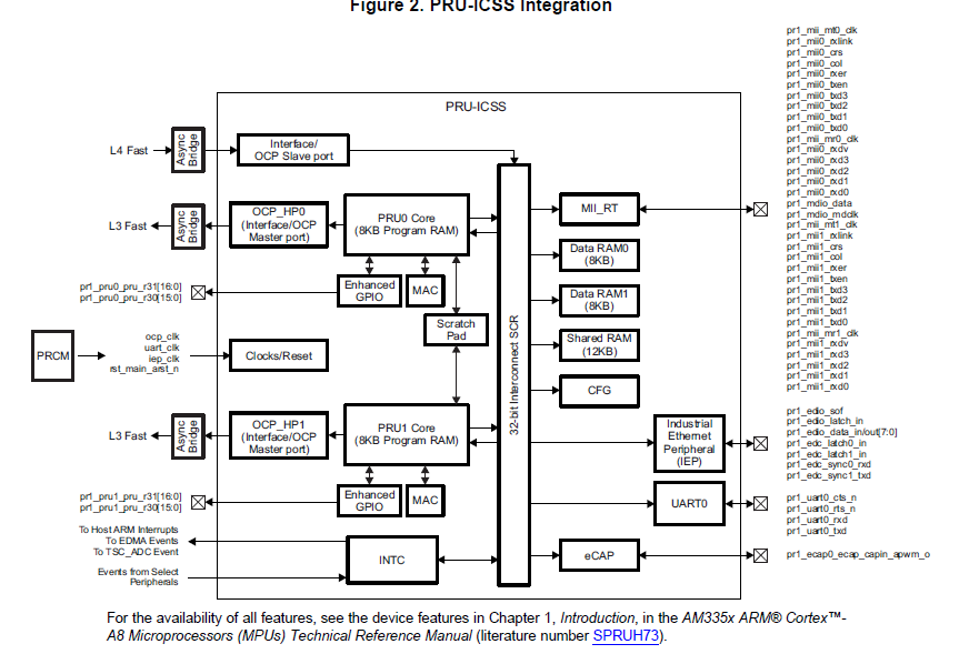

I would like to use the PWM of the PRU (AM335X) in the Beaglebone black, but I can't find a good example follow, more especific a want to use eHRPWM
I need to execute the code and acess the registers  on CCS, without using the linux
Thanks in advance

  • Your question is very confusing: are you asking about eHRPWM or about PRU ? They are completely unrelated
  • you are right I get that wrong, They are unrelated. How could I make the pru get acess to the pwm of am335X, therefore use the pru to enable the pwm output?
    The pwm is timebased with a fixed duty cycle. The application is to allow events  triggering in ADC conversion.
    Do you think  is better in my situation to work with timer interruption and the enhanced gpio?
  • Hello Orlem,
    Could you tell us more about your use case? It sounds like you have an external ADC chip collecting data. What is the data collection for? Does the data need to be processed? Is your application controlling everything going to run in userspace or the kernel? Does the controlling application need access to all of the ADC data, or just to be notified when something occurs (e.g. overvoltage monitoring)?
    One possible PRU-based solution (which may or may not be the best fit for your design) is to use the PRU GPI/GPO pins to control the external ADC and receive data from it - since most PRU instructions take exactly 5ns to execute, you can time waveforms coming out of the PRU GPO exactly. The PRU can then be used to process the ADC data.
