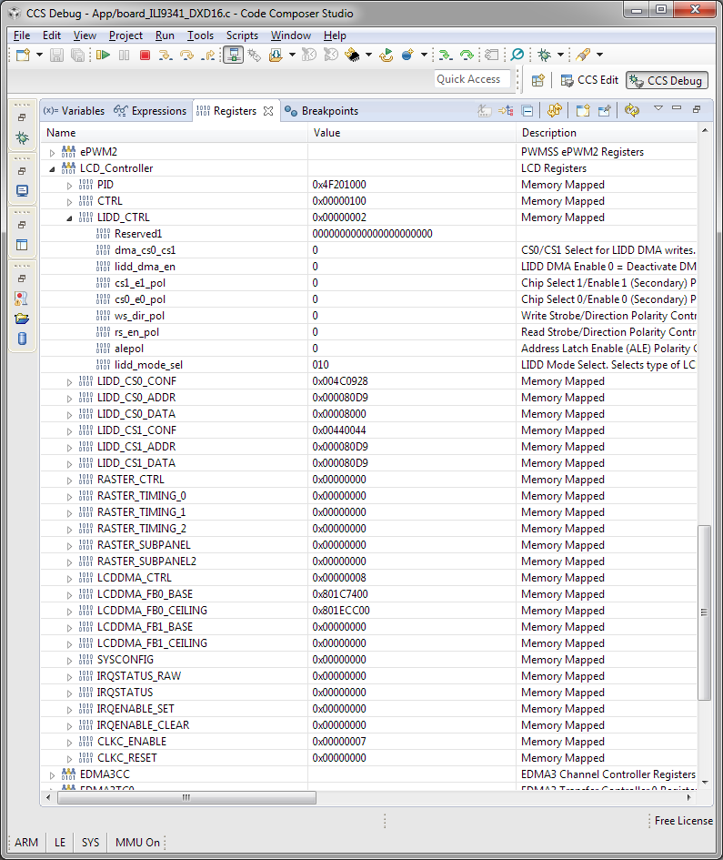

I'm running the Sitara LCD interface under TiRTOS, in LIDD mode, to an ILI9341 based display, and everything is working fine except that I can't get the LCDC DMA unit to work at all.
The display gets initialized, and addresses written etc., using normal non-DMA writes.  And up until now I have been downloading the display image byte-by-byte in a tight little loop. But for a faster transfer of the entire display image I wanted to switch to DMA mode, send the data, then switch back when the transfer has completed.
Below is a dump of the LCDC registers immediately prior to setting the lidd_dma_en bit to launch the transfer.  I can't show a dump with this bit set, as -- and this is the first bit of weirdness -- reading the registers while in LIDD DMA mode causes a hard crash, with the CPU completely off in the weeds.  The documentation does indicate that the reads and writes to the LIDD_CSx_DATA registers are not permitted in LIDD DMA mode, but a hard crash is an unusual response.
The other bit of weirdness that I see is that when I enable the DMA clock, along with the core and LIDD clocks, via the CLKC_ENABLE register during normal post power up initialization, the DMA clock enable doesn't stick.  When I go to start the first DMA transfer it has been cleared.  This is easily overcome by enabling the clock prior to the transfer, but it does seem odd.
I don't have any of the interrupts enabled, intending simply to poll the done bit in IRQSTATUS_RAW.  But we never get there.  In fact, looking at the LCD CSX output on the scope shows no activity whatsoever when DMA is launched.
If anyone can see the problem here I would be more than happy to be shown the error of my ways!

    The SDK is pdk_am335x_1_0_3.  I'm not using any particular test example or driver, but going direct to hardware via calls at the HW_WR_REG32 level.
    Everything else is working fine -- it's just the DMA that won't budge.

    File attached below.  I've copied in a number external functions at the end of the file, so it should be pretty much self-contained.
    There are some references to "gDisplay" and "gdisp" etc. which are part of the uGFX graphics package that I am using.  They don't impact the transfer function itself.  When the package interfaces with the display it is through the functions write_index() and/or write_data(), which are shown.
    The main transfer function is board_ILI9341_DXD16_CopyAll(), at line 236.
    GerryL

  • GerryL,
    Please take a look at this old e2e thread e2e.ti.com/.../2063795 where someone was trying to access the LCDC registers. The customer never came back to confirm what JDD suggested in the final post, but please digest this thread to see if there is something of value to your question.
    Lali
  • Hi Lali,
    Thanks for the link.  The clocks mentioned in that post have all been enabled . .
    "-enable the LCDC functional clock 0x44e00018=0x2" -- this is register CM_PER_LCDC_CLKCTRL, and for my application this is done just after power up in a call to am335x_prcm.c/PRCMModuleEnable(), moduleId=CHIPDB_MOD_ID_LCDC.
    "-Add *0x4830E06C in the expressions window and set *0x4830E06C=0x7, that will enable the clocks to the submodules." -- this is the LCDC register CLKC_ENABLE, and in my sample code it is set to value 0x07, which enables the Core, LIDD and DMA clocks.
    At this point I have to ask whether or not there are any issues with the LCDC DMA implementation in the AM3352?  If anyone on this forum has seen it working then please speak up, as I am beginning to have my doubts.
    GerryL
  • GerryL,
    I should have caught this earlier, but there is a LCDC DMA example in the pdk_am335x_1_0_10!! located at C:\ti\pdk_am335x_1_0_10\packages\MyExampleProjects\LCDC_RasterExample_evmAM335x_armTestProject
    It's part of the latest Processor SDK RTOS package from here http://software-dl.ti.com/processor-sdk-rtos/esd/AM335X/latest/index_FDS.html
    Did you want to give this a whirl and see if it works?
    Lali
