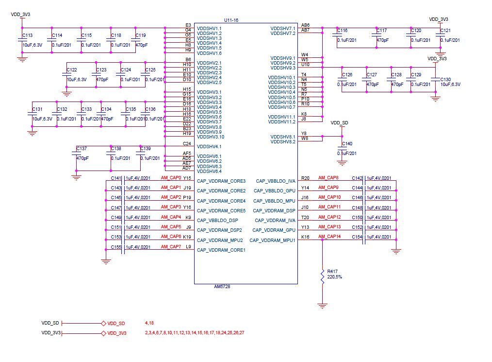

I read the refer manual about AM5728 EMMC/SD/SDIO (25.2), So The MMC3 instance support 1-, 4-, and 8 bit data transfers.
I design the MMC 3 interface to read/write SD card with 4 bit data bus on my Board.
And, I configure the device tree as flows:
But I can not find the SD card on my board by mmc3 interface.
The scan sd card command:
fdisk -l
I Missed something?

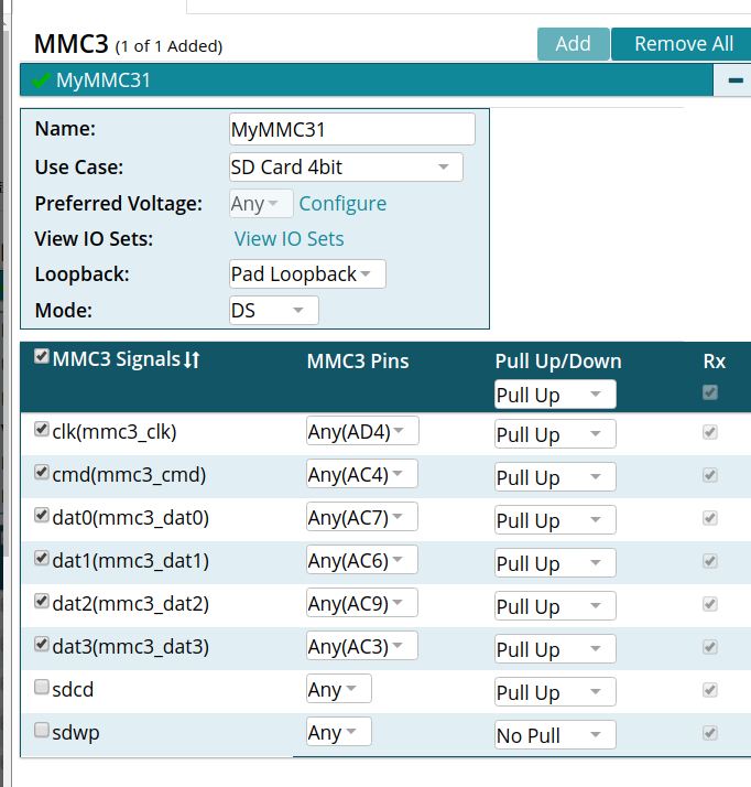

    /* * DEVICE TREE FORMAT PADCONF * */

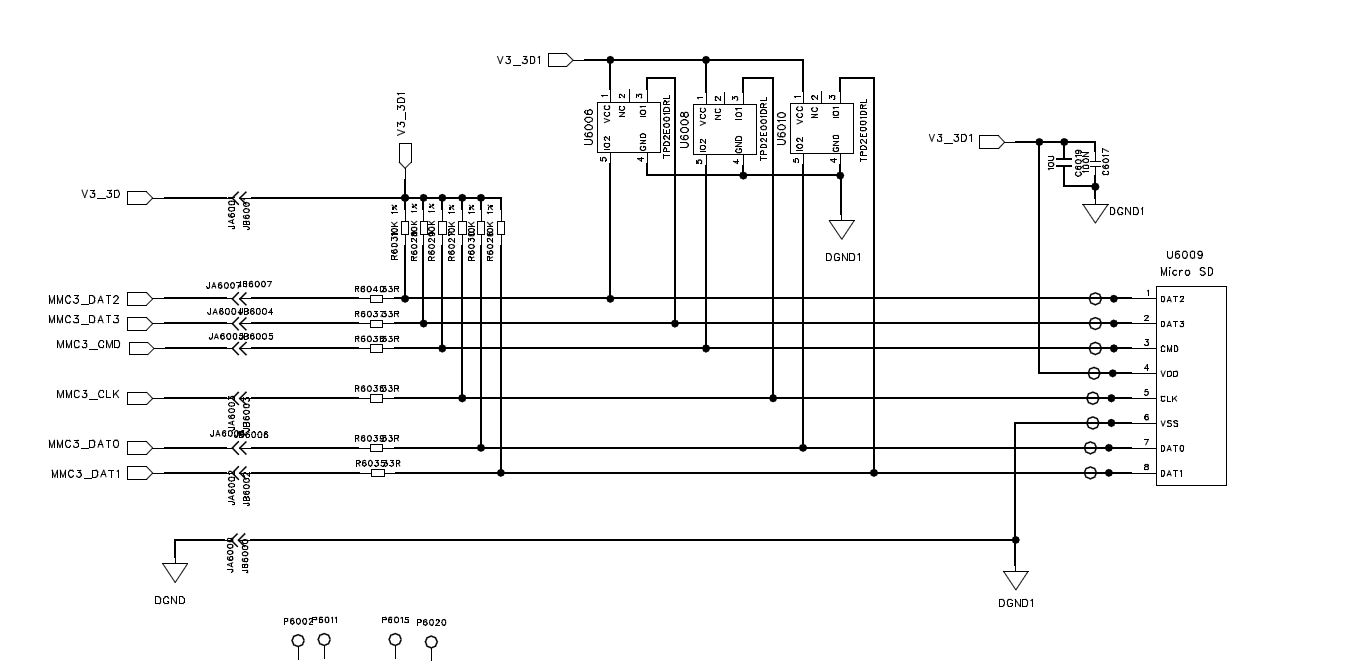

    The mmc 3 interface on my board :

    Consider that MMC1 and MMC3 support different frequencies. See also how power/voltage is applied on EVM MMC1 and compare/align with your custom board MMC3.

    MMC3 supply VDDSHV7 did not the same as MMC1 VDDSHV8, So how can I modify the "vmmc-supply = <ldo1_reg>"?

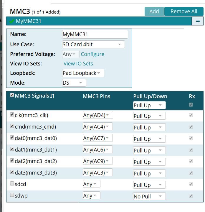

    I add the following content in the device tree,But MMC3 still fails to mount the device, and need to modify the kernel?

    As posted by Pavel you should use the officially released Processor SDK RTOS. Then select only one mmc3_pins configuration and use it as "default", you shouldn't have pinctrl-names = "default"; and then add 4 different mmc3_pins configurations.
    Then for vmmc-supply, make sure you use an ldo that is listed in the tps659038_pmic regulators subnode. Or if you use fixed power supply make sure that the corresponding fixed-regulator is listed in the dts file.
    Also make sure you also have the mmc3 and its pinmux settings configured in u-boot code as well.
