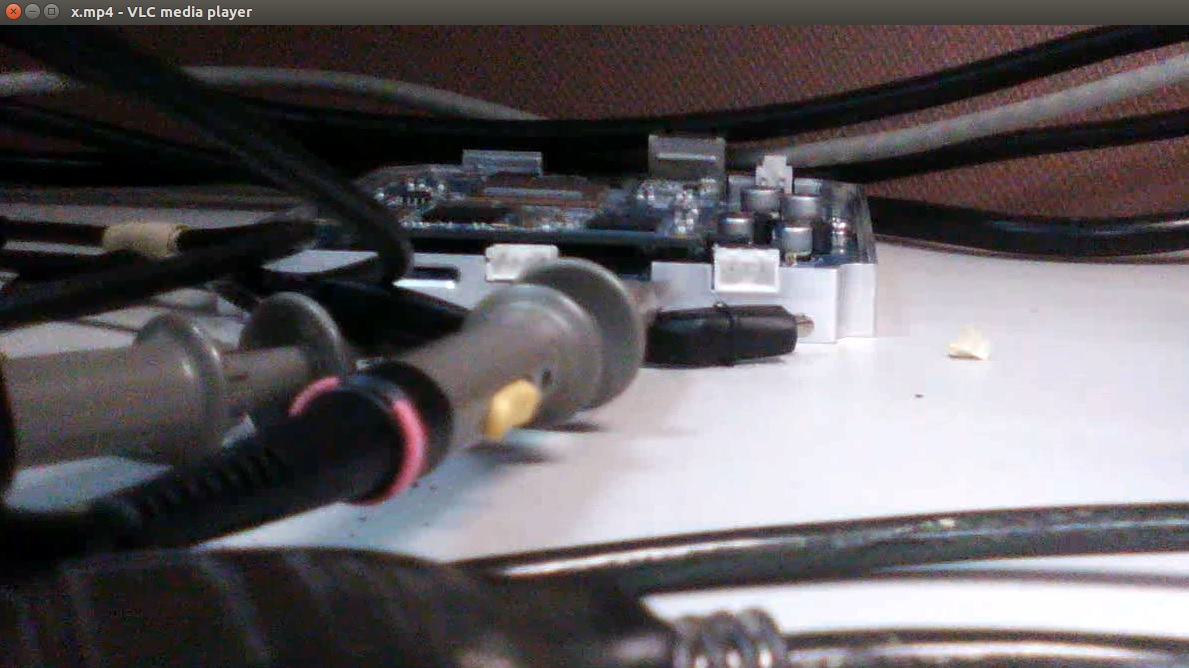

    Yes, it works fine on EVM board. Below is the screen.
    According to your experience, what is the possible root cause of this issue?
    Any clues would be appreciated, I will pass the information to our HW team.

    This is the result on my side:
    root@am57xx-evm:~# ls -l /dev/rpmsg*
    crw------- 1 root root 242, 1 Mar 26 15:23 /dev/rpmsg-dce
    root@am57xx-evm:~#
