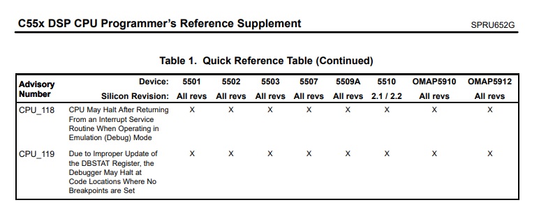

In the SPRU652G document - 3 C55x CPU Known Design Advisories to Functional Specifications 13
CPU_119 Due to Improper Update of the DBSTAT Register, the Debugger May Halt at Code Locations Where No Breakpoints are Set 5
Was CPU_119 ever fixed?  Since DBSTAT is in the 'middle' of the sysstack part of the processor's stack ('c5535/c5545) - this can be quite difficult to deal with.
Has SPRU652G been updated since RevG?
From my experience debugging these parts, it would appear CPU_119 is still an issue - is that correct?
