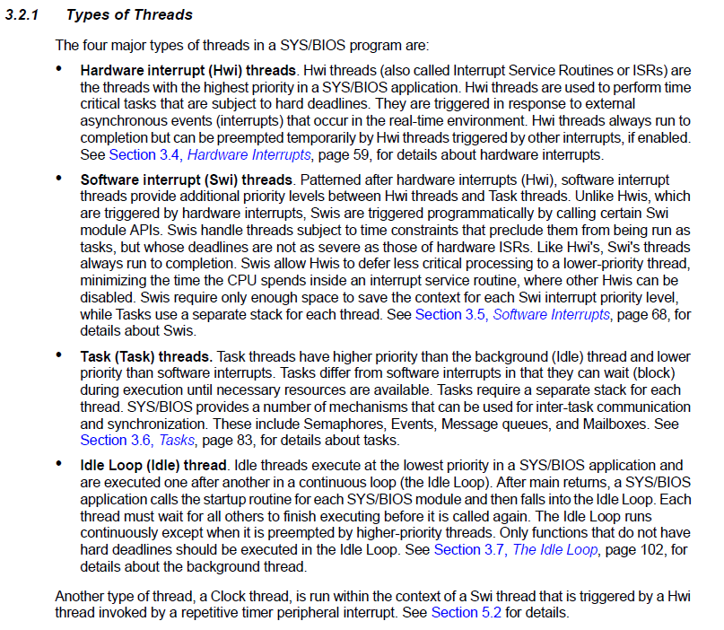

  • Kanae,
    Not sure which version of BIOS you are on, but if you see the users guide at C:\ti\bios_6_52_00_12\docs\Bios_User_Guide.pdf, please see the below section on thread priority.
    On your question on is support in AM335x, there are several e2e threads that mentions the use of this BIOS parameter
    Hope this helps.
