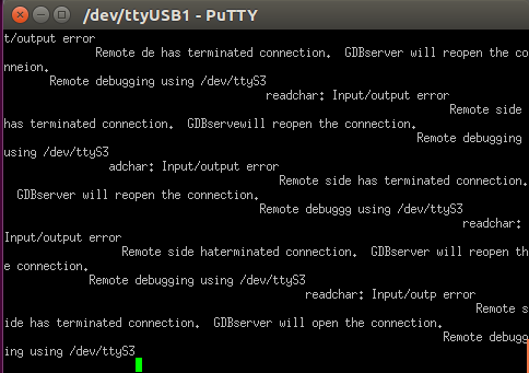

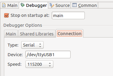

I'm trying to debug a Linux application with GDB using the USB Interface of the device. In other examples Ethernet connection is used to debug applications, however I can't use the Ethernet ports as I'm running an industrial communication protocol on them. Thus, as I understand I don't have any other option rather than the USB port.
I followed these instructions to setup GDB with CCS, but using Serial Communication instead of TCP:
This is my connection setting:
By default the board uses the UART3 for serial console, thus I run this command to initialise the GDBServer:
gdbserver /dev/ttyS3 myApp
However when I launch the application from CCS, the GDBServer goes crazy:
I would appreciate any advice to debug Linux applications from CCS without using the Ethernet ports.

  • Hi Alvaro,
    Your host CCS configures /dev/ttyUSB1 port, which is the board usb serial port. But your board gdbserver listens to /dev/ttyS3 which is the board UART3 port. Both gdb and gdbserver are not on the same channel, right?
    You need to decide either use UART or usb serial channel, then configure both CCS gdb and board gdbserver on both ends of the same channel.
    BTY, please don't change the USB kernel configs, just use tisdk_am335x-evm_defconfig in the SDK kernel, which has all the related USB config options enabled.
  • Hi Bin Liu,
    Yes, My host CCS configures /dev/ttyUSB1 port, but because it is the USB serial port of the computer not of the board. The board has two serial ports, ttyS0 and ttyS3. ttyS3 is configured as console output in the uboot configuration file. I guess ttyS0 is the DB9 connector used for CAN/Profibus.
    Moreover, I can see with Putty that I'm connected to the ttyS3 port on the Splash Screen:
    Thus both ttyUSB1(PC) and ttyS3(Board) endpoints are in the same channel. My guess is that I can't use the same serial connection for the console output and gdbserver, they must run separately. Therefore it would be great to configure the USB as a gadget, then I could use SSH and GDB running on different ports but with the same USB connection... However I'm struggling to set up the USB Gadget, I require some documentation or hints to proceed with that.

    Thanks in advance,
    Álvaro
