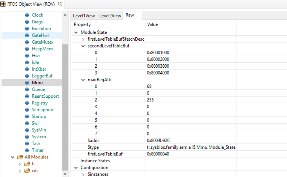

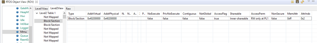

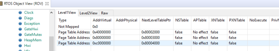

    1. Load your application, it should go main(). Don't run (otherwise your code crash when accessing FATFS or DMA didn't work). The SYSBIOS should setup the MMU already
    2. Use CCS ----->Tools----->ROV classic, then look at Mmu
    3. From raw, you should see the value of MAIR0 to 7, also location of first/second level MMU table
    4. From Level2View, each block is 2MB, you can see each memory region (for you it is 0x4000_0000, not 0x8000_0000, not 0xc000_0000)
    You can check if you missed any region, what index used and region property.
    Regards, Eric
  • Hi Eric,
    Thank you for the information on where to view the MMU mapping in the ROV!
    The SRAM and OCMC_RAM's were being mapped to attrIndx 2. So I took out all of our individual mapping and used the for loop method to map a large section that I found in one of the TI example projects. We also switched back to using the defaults for MAIR index 0 = 0x44, 1 = 0x04, and 2 =0xFF. The combination of these changes seemed to fix our issues. Our collection via DMA is now working along with the FATFS commands. Thank you again for the guidance through this issue!
