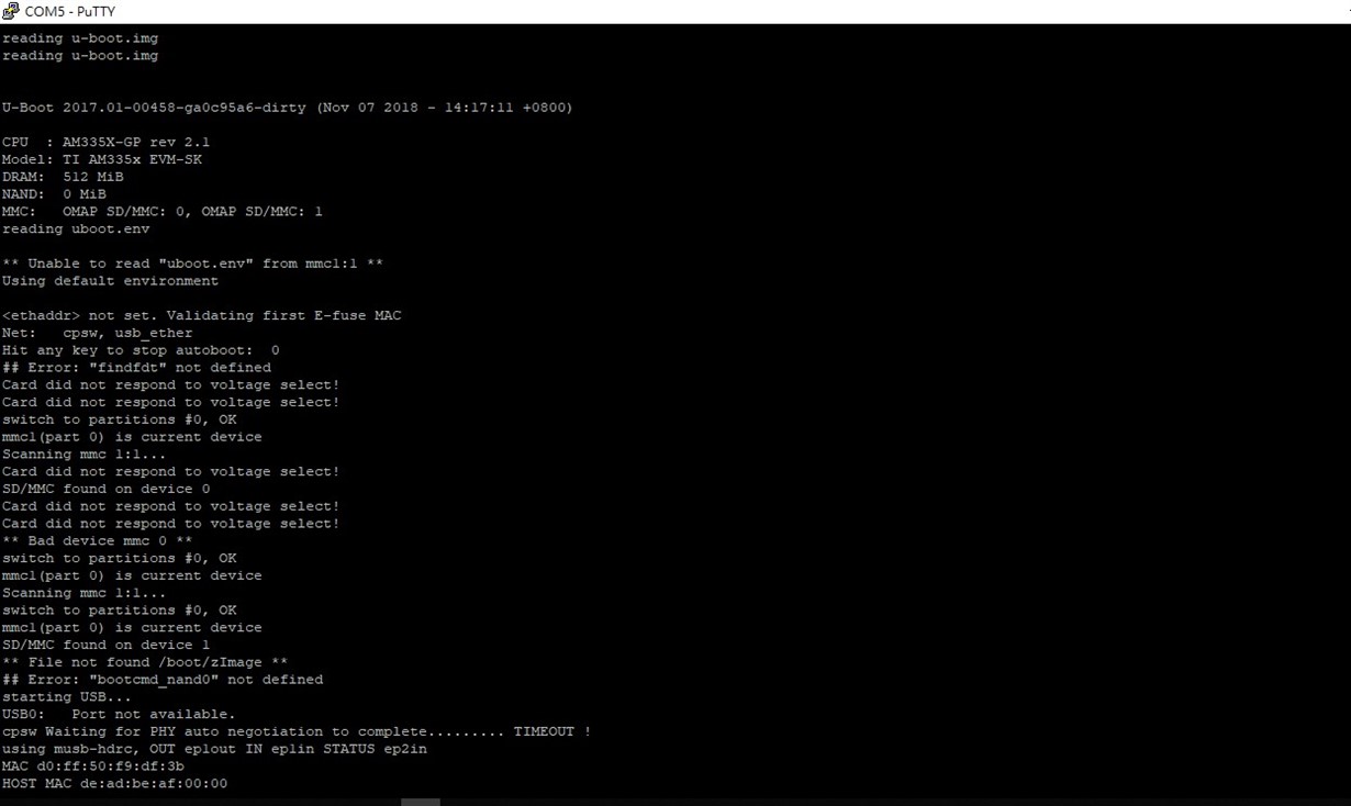

Hi Ti team,
I used SD flash emmc fail occur error, caused by modifying the am335x_evm.h
so, I boot to share always select emmc and emmc boot fail.
Currently EMMC BOOT is still unsuccessful,
So I want to restore with SD card but modify the bootenv settings and archive, show "bad device mmc1"
How can I restore or correctly write the env settings?

    I downloaded the TI SDK 05.01.00.11 version and re-doed the flash emmc but it still failed. Below is the flow of my steps.
    On board emmc is 16G  , SD 128G  2 Partion boot (MLO, u-noot.img ,UImage, Zimage)   rootfs(file system) .

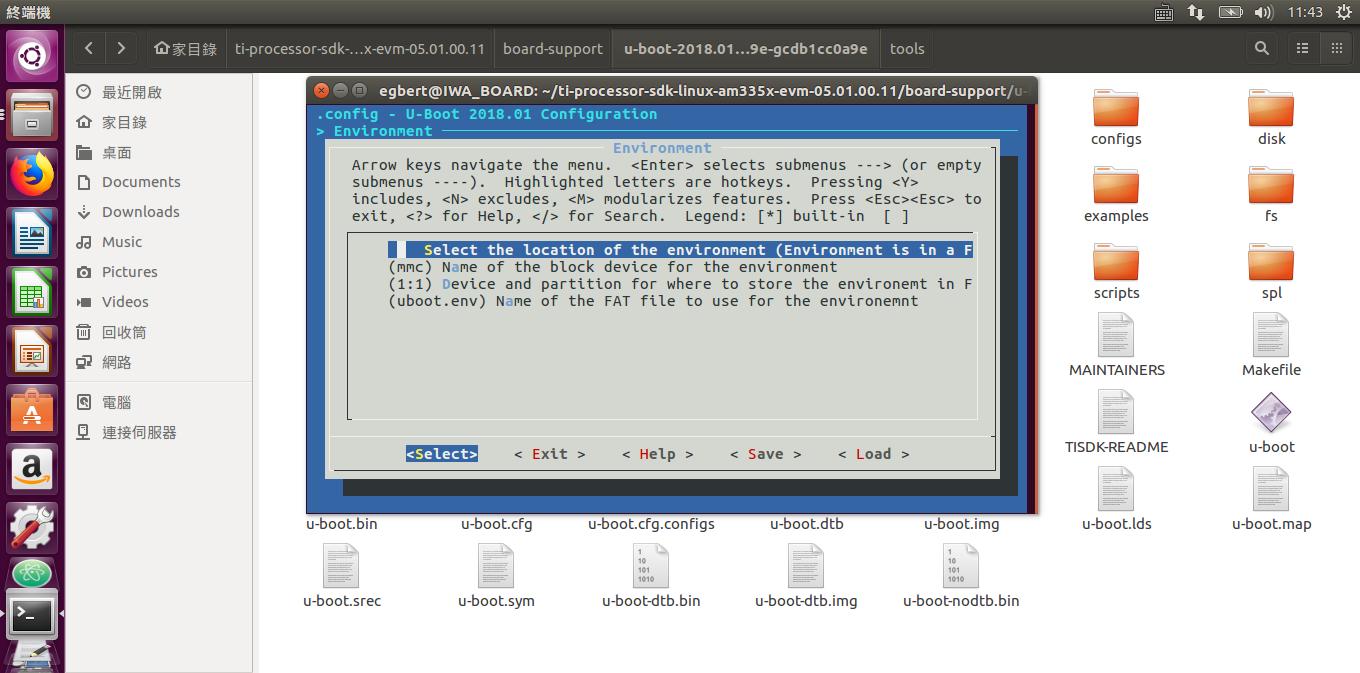

    1. u-boot environment in a file on eMMC in this way.
    Environment  ---> (1:1) Device and partition for where to store the environemt in FAT
    Changing the (0:1) to (1:1) will make the uenv.env to save and load from eMMC.
    Exit

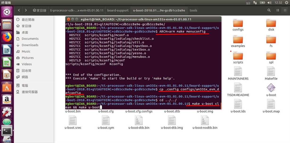

    $ cp .config configs/am335x_evm_defconfig
    $ cd ../../
    $ make u-boot_clean && make u-boot
    Copy  new update u-boot.img to SD card, then flash EMMC  and follow below step :

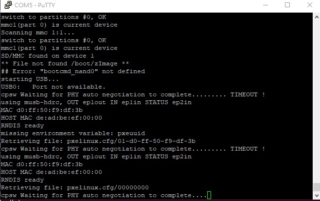

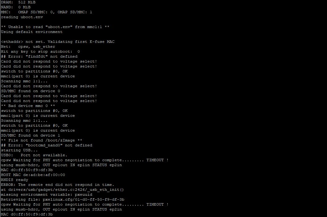

    Used EMMC boot is  Timeout.......
    I used the u-boot  command:     printenv     status below:

    I have the following questions:
    1. Can tell me all the files and parameters in the SDK need to be modified in order to complete the function of flash emmc ?
    2. Does TI have any usermenu description of the usage of the parameters in am335x_evm.h?
    3. I have searched for various ways of using the relevant SD flash emmc on the network. I have been asking different questions and it is impossible to determine which way is the official correct way.

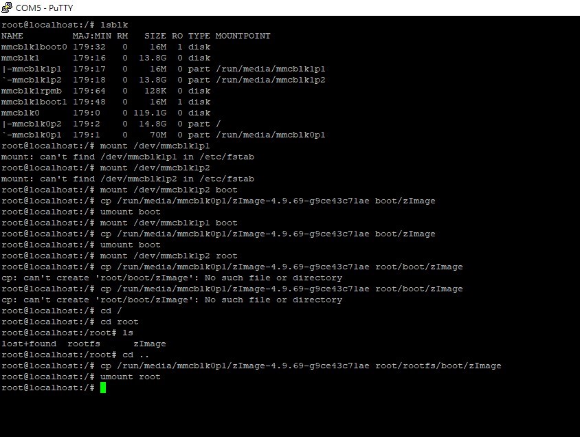

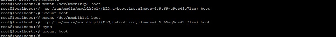

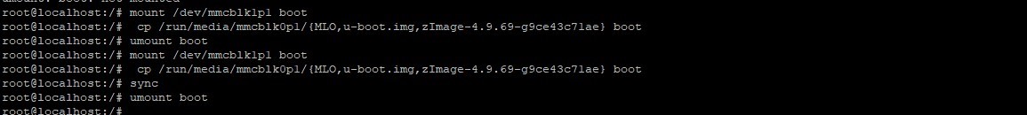

    I try to change UImage change to Zimage  ,   Can I use below change image file to flash emmc ?
    Copy the {MLO,u-boot.img,uImage} files to the first partition:
    2.1. mkdir boot
    2.2. mount /dev/mmcblk1p1 boot
    2.3. cp /media/mmcblk0p1/{MLO,u-boot.img,uImage} boot
    I will change this commad =>  cp /media/mmcblk0p1/{MLO,u-boot.img,ZImage} boot
    2.4. sync
    2.5. umount boot

    But the result is still can not index Zimage space !!!!!!

  • Use this command after mounting the /dev/mmcblk1p2 partition.
    cp /run/media/mmcblk0p1/zImage-4.9.69-g9ce43c71ae root/boot/zImage

  • You have a redundant rootfs directory. You need to move all the stuff from root/rootfs/* to root/ directory.
  • Hi Kemal,
    Thank you for your guidance and reminder, the problem has been solved.
