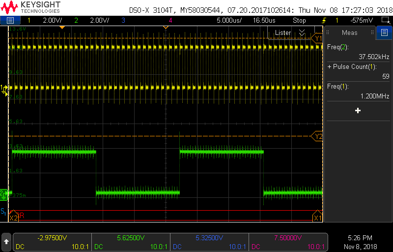

I need to transfer PCM formatted data (8kHz samplerate / 16bit per sample / stereo) via McASP0 on BBB.
I found some articles and apply to my system like below:
- delete McASP0 pinmuxing and related things in am335x-boneblack-common.dtsi.
- add McASP0 pinmuxing and PCM5102a codec binding to am335x-boneblack-pcm5102a-int_clk.dtsi:

- And include this dts to am335x-boneblack.dts
The PCM5102A codec is detected on my BBB with above and I execute below command:
# aplay ~/1kHz_sinewave_8000_16.wav
I expect FSX is 8kHz but the FSX is 24kHz (three times). When I try with 16kHz sampled, FSX is 48kHz (three times). Is it okay?
Can I get your opinion about this issue?
