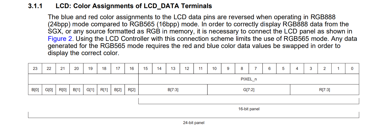

We are interfacing 7' inch 24-bit LCD display, The panel comes up and sensing touch screen properly but it is not showing 24-bit color. We have updated device tree files, please find the attached dts files below.
Kindly suggest what wrong.

&lcdc {
    status = "okay";
    blue-and-red-wiring = "crossed";

    lcd_pins_default: lcd_pins_default {
        pinctrl-single,pins = <
            AM33XX_IOPAD(0x820, PIN_OUTPUT | MUX_MODE1)    /* gpmc_ad8.lcd_data23 */
            AM33XX_IOPAD(0x824, PIN_OUTPUT | MUX_MODE1)    /* gpmc_ad9.lcd_data22 */
            AM33XX_IOPAD(0x828, PIN_OUTPUT | MUX_MODE1)    /* gpmc_ad10.lcd_data21 */
            AM33XX_IOPAD(0x82c, PIN_OUTPUT | MUX_MODE1)    /* gpmc_ad11.lcd_data20 */
            AM33XX_IOPAD(0x830, PIN_OUTPUT | MUX_MODE1)    /* gpmc_ad12.lcd_data19 */
            AM33XX_IOPAD(0x834, PIN_OUTPUT | MUX_MODE1)    /* gpmc_ad13.lcd_data18 */
            AM33XX_IOPAD(0x838, PIN_OUTPUT | MUX_MODE1)    /* gpmc_ad14.lcd_data17 */
            AM33XX_IOPAD(0x83c, PIN_OUTPUT | MUX_MODE1)    /* gpmc_ad15.lcd_data16 */
            AM33XX_IOPAD(0x8a0, PIN_OUTPUT | MUX_MODE0)    /* lcd_data0.lcd_data0 */
            AM33XX_IOPAD(0x8a4, PIN_OUTPUT | MUX_MODE0)    /* lcd_data1.lcd_data1 */
            AM33XX_IOPAD(0x8a8, PIN_OUTPUT | MUX_MODE0)    /* lcd_data2.lcd_data2 */
            AM33XX_IOPAD(0x8ac, PIN_OUTPUT | MUX_MODE0)    /* lcd_data3.lcd_data3 */
            AM33XX_IOPAD(0x8b0, PIN_OUTPUT | MUX_MODE0)    /* lcd_data4.lcd_data4 */
            AM33XX_IOPAD(0x8b4, PIN_OUTPUT | MUX_MODE0)    /* lcd_data5.lcd_data5 */
            AM33XX_IOPAD(0x8b8, PIN_OUTPUT | MUX_MODE0)    /* lcd_data6.lcd_data6 */
            AM33XX_IOPAD(0x8bc, PIN_OUTPUT | MUX_MODE0)    /* lcd_data7.lcd_data7 */
            AM33XX_IOPAD(0x8c0, PIN_OUTPUT | MUX_MODE0)    /* lcd_data8.lcd_data8 */
            AM33XX_IOPAD(0x8c4, PIN_OUTPUT | MUX_MODE0)    /* lcd_data9.lcd_data9 */
            AM33XX_IOPAD(0x8c8, PIN_OUTPUT | MUX_MODE0)    /* lcd_data10.lcd_data10 */
            AM33XX_IOPAD(0x8cc, PIN_OUTPUT | MUX_MODE0)    /* lcd_data11.lcd_data11 */
            AM33XX_IOPAD(0x8d0, PIN_OUTPUT | MUX_MODE0)    /* lcd_data12.lcd_data12 */
            AM33XX_IOPAD(0x8d4, PIN_OUTPUT | MUX_MODE0)    /* lcd_data13.lcd_data13 */
            AM33XX_IOPAD(0x8d8, PIN_OUTPUT | MUX_MODE0)    /* lcd_data14.lcd_data14 */
            AM33XX_IOPAD(0x8dc, PIN_OUTPUT | MUX_MODE0)    /* lcd_data15.lcd_data15 */
            AM33XX_IOPAD(0x8e0, PIN_OUTPUT | MUX_MODE0)    /* lcd_vsync.lcd_vsync */
            AM33XX_IOPAD(0x8e4, PIN_OUTPUT | MUX_MODE0)    /* lcd_hsync.lcd_hsync */
            AM33XX_IOPAD(0x8e8, PIN_OUTPUT | MUX_MODE0)    /* lcd_pclk.lcd_pclk */
            AM33XX_IOPAD(0x8ec, PIN_OUTPUT | MUX_MODE0)    /* lcd_ac_bias_en.lcd_ac_bias_en */

  • Was color working previously with this LCD?
    Nick
  • Also, please describe in more detail what issue you are observing. What do you mean when you say "it is not showing 24-bit color"?
    Nick
  • FYI, the previous post is at e2e.ti.com/.../749590
    This Lcd was working previously, we are using 7 inch 24-bit lcd. we have a problem with lcd display it is showing like negative images. Please find the attached images below.
    7848.Lcd.zip
    Could you please tell me which PSDK Linux you are using?
    Krunal
  • sdk 5.1, looks like they are using Linux 4.14.67-gd315a9bb00
    Based on the AM335x silicon errata, please keep the following in mind: “The blue and red color assignments to the LCD data pins are reversed when operating in RGB888 (24bpp) mode compared to RGB565 (16bpp) mode.”
    PSDK Linux already accounts for the bug and no software changes are required. In the previous post, you mentioned it was working and I am wondering if you have changed anything in the DTS files. Also, if you are using 16bpp you need to configure a few of the files as mentioned in the following document
    Krunal
    We worked with the same lcd and bbb with STARTERWARE-AM335X: StarterWare for AM335x Processors previously, this lcd was working properly with STARTERWARE-AM335X.
    Now  trying to do with PROCESSOR-SDK-LINUX-AM335X and strucked at above mentioned issues.
    In PSDK Linux 5.1, could you please navigate to the file "am335x-boneblack-common.dtsi" and ensure the blue-and-red-wiring is set correctly based on your setup.
    Krunal
  • I just wanted to confirm if your LCD is connected in the following orientation:
    Krunal
    We did the following below changes in  /drivers/video/fbdev/da8xx-fb.c according to errata, but we still have a problem with with the color. when we powered up the board on top left side showing green mark( -- ) and that all the names coming in matrix all are in green color. Kindly suggest what's wrong.
    case 24:
    var->red.offset = 16;
    var->red.length = 8;
    var->green.offset = 8;
    var->green.length = 8;
    var->blue.offset = 0;
    var->blue.length = 8; */
    var->red.offset = 0;
    var->blue.offset = 16;
    We do not support fdev display driver and please use drm driver instead. Also, based on my discussion with our developer, the SDK Linux already accounts for the errata. The user just needs to modify the file "am335x-boneblack-common.dtsi" and ensure the blue-and-red-wiring is set correctly based on their setup.
    Krunal
    We solved color issue successfully with your help, and now we structed at new problem i.e. some of the touch inputs (x-coordinates) are not sensing. When we are trying to calibrate the touch screen left side portion of lcd is not sensing. Please find the below.
    x-coordinates are sensing from 135-799.
    y-coordinates are sensing from 0-479.
