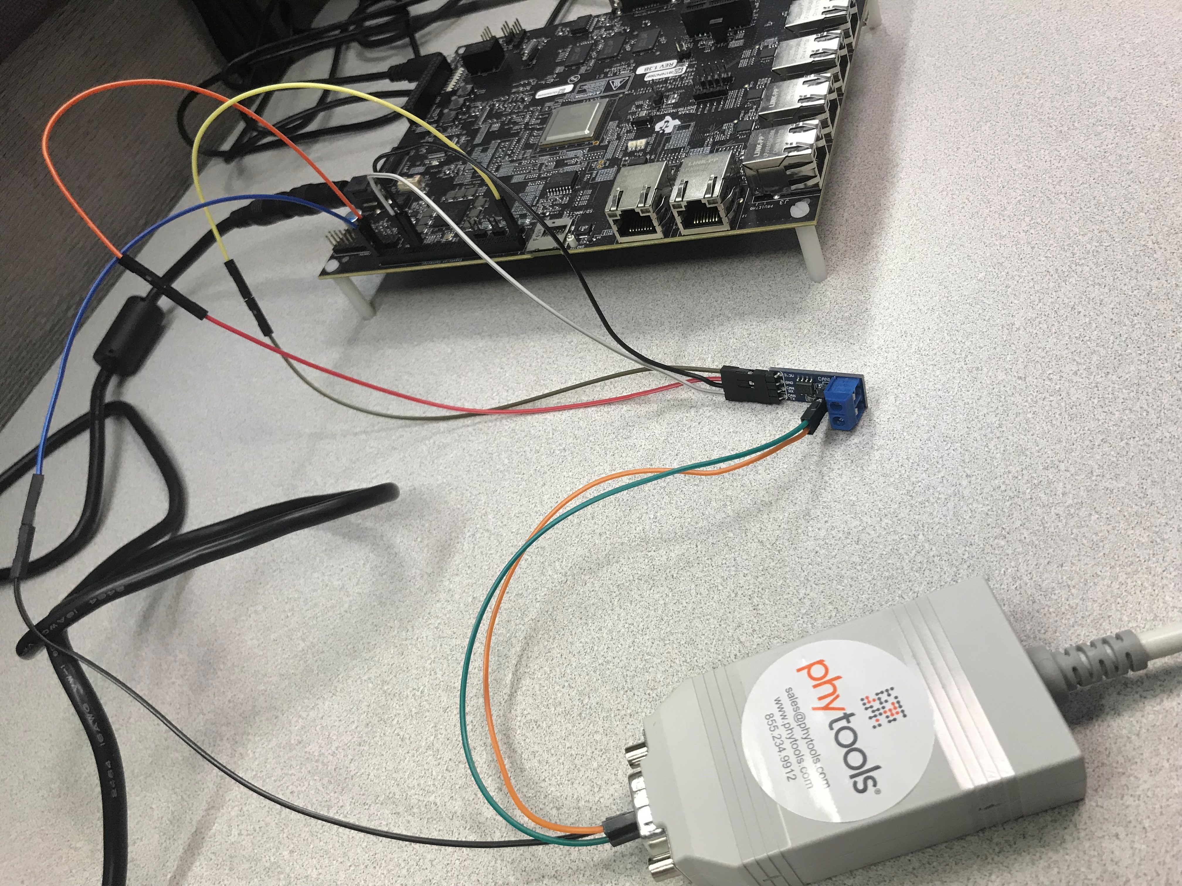

Using the information provided by Pavel in the linked thread, I have configured my Board to use the DCAN2 interface through the J21 Expansion connector.
I have made the following adjustments in the for the DCAN Example Project:
Macros:
#define DCAN_MSG_OBJ_RAM_ADDR           ((SOC_DCAN2_MESSAGERAM_BASE) + (DCAN_MSG_OBJ * DCAN_MSG_OBJ_SIZE))
Function Definitions:
ExecTest():
        gDcanAppInstance = DCAN2_APP_INST;
        DCAN2Prcm_clck_ram();
I believe these are the only places where I am able to distinguish between DCAN1 and DCAN2.
When I run my test, I am not getting output from the EVM to the PCAN. I can see the register values populating at 0x4848_0000 (the correct DCAN2 address) as the messages are attempted to be transferred out of the EVM.
I have confirmed my connections are correct going to and from the CAN Transceiver.
Please assist me in troubleshooting this issue.

    I have continued to investigate this issue with the DCAN2 interface. With a fresh re-population of the SDK and PDK, I have tried re-running this test using the EVM in normal mode. So to be clear, the only change I've made within the code is here (the commented out lines are above the replaced code):
    This allows me to communicate to and from the PCAN device.
    Starting out, I am connected through DCAN2 interface as shown in my original posting. Then, I ran the DCAN Loopback External Example Project, using option 1 (in Normal Mode!), I enter a single frame, and the PCAN receives it! I send a frame from the PCAN using the proper MsgID, and it accepts it at the EVM, and the application returns to the main menu.
    While leaving the application running, I am able to disconnect from J21 Expansion Connector, and put the PCAN jumper wires into the J38 DCAN Header Pins. Again using option 1, I send another frame, and PCAN receives it as well!
    I have verified this with a coworker, using THEIR EVM board, and THEIR PCAN connector. We were able to reproduce the same results as described above.
    How is this possible??? Is the CAN on the same bus??? How do I distinguish one CAN interface versus the other? Simply choosing the DCAN2 instance and clock/pinmux makes the program get halted while waiting for RX to be done. While it makes sense that the CAN Bus is hot-swap-able, it doesn't make sense that the two CAN interfaces on the AM5728 SOC are in the same bus. I am looking at the TRM to figure this out.
    Please help me to comprehend what is the way to make these DCAN interfaces separate, so we can connect two nodes to the EVM.
    Thank you,
    Alec
  • Okay so as shown here, I have determined they ARE on the same CAN Bus.
    I must ask the experts, how do I use the DCAN 1 & 2 interfaces separately?

  • Alec,
    If you look closely at the schematic, the AM57x IDK only supports DCAN 1 (pins G19 and G20)
    DCAN2 is not supported on the EVM as those pins are muxed to another peripheral.
    Lali
  • Lali,
    That's what I was thinking based on my findings. Thanks for confirming.
    Please clarify for me, if I were to use the AM5728 SOC on a custom board, I would be able to mux the pins for DCAN 2 to function, correct? How would I differentiate between DCAN1 and DCAN2 in that situation (software-wise)?
