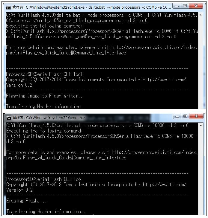

I am having a try about programming FlashWriter on AM65xx Platform via TI's uniflash tool.
I was following http://software-dl.ti.com/processor-sdk-rtos/esd/docs/latest/rtos/index_board.html#programming-flashwriter-on-am65xx-platform steps by steps.
It was all OK until I execute  C:\ti\uniflash_4.5.0>dslite.bat --mode processors -c COM6 -f C:\ti\uniflash0\processors\uart_am65xx_evm_flash_programmer.out -d 3 -o 0
The command line outputs   "Transferring Header information.." ,
but it remains this status after I wait for 30 minute.
I also tried Erasing Flash Device according to http://software-dl.ti.com/processor-sdk-rtos/esd/docs/latest/rtos/index_board.html#erasing-flash-device-on-the-target-platform
I execute the command C:\ti\uniflash_4.5.0>dslite.bat --mode processors -c COM6 -e 10000 -d 3 -o 0
The command line also outputs "Transferring Header information.."  and remained this status didn't outputs "Flash Programming Success!"
I wonder why it is always "Transferring Header information.. ",what problem I met?

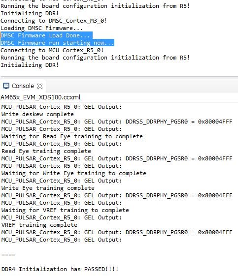

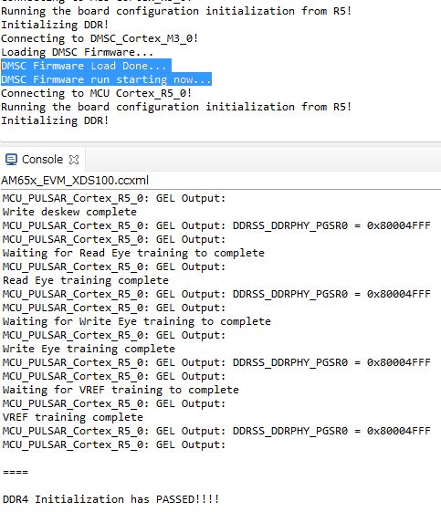

  • Hi Rahul
    thanks very much, I really appreciate your help.
    but it still doesn't work.
    step1 is OK. I have downloaded it.
    about step2,my output in CCS is as below, does it meas that I have already configure DDR and load the DMSC firmware successfully?
    and
    step3~step6 are all the same as your answer.
    but   when I execute dslite.bat --mode processors -c COM6 -e 10000 -d 3 -o 0
    still remains Transferring Header information.. and cannot goes on.

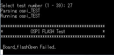

    and I run the SD card diag program to test OSPI
    result is as below, does it means that there is something wrong with my board's OSPI flash?
