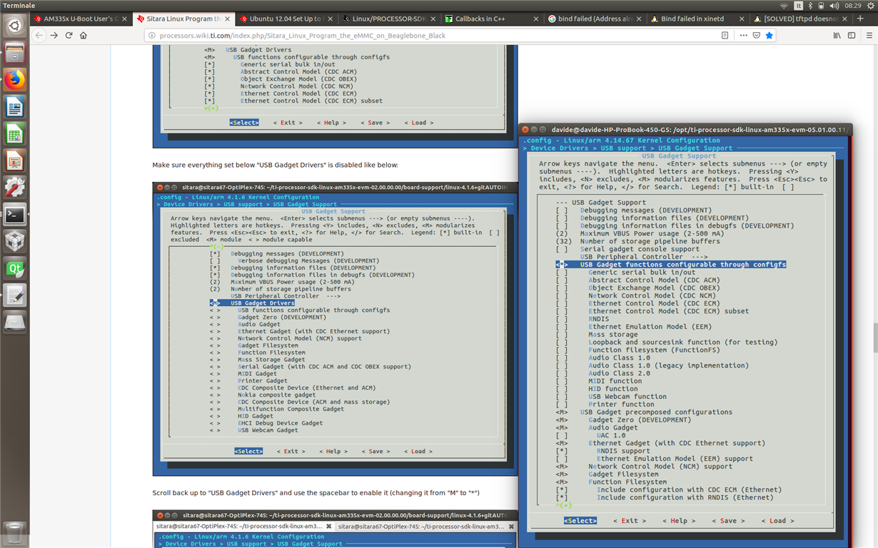

  • Hello Ron,
    thank you for your support. Regarding the tftp-server issue, I'll search on internet for a solution. However I've still got a doubt about the kernel menuconfig issue following the procedure
    As you can see in the picture below, the settings shown in the procedure (on the left of the picture) are totally different compare to the current kernel version arm 4.14.67 Kernel Configuration (on the right of the picture). Can you confirm me that it's correct to remove all the options as I did in the picture? Besides, if in the next future, I want to enable CDC, can I enable the CDC options without introducing issues for the tftp server?
    Thank you.
  • Hello Ron,
    I've done some more steps forward. What I did, was comment out the file /etc/default/tftp-hpa. I'm not still sure but if xinetd launches /etc/xinetd.d/tftp, it conflicts with /etc/default/tftp-hpa.
    Now I've got the following on beaglebone UART:

    Hello Ron, I've got some questions:
    1. As you can see there are some complaints about the pxelinux.cfg/01-e8-eb-11-27-b9-2d', which is missing? Do you know something about that?
    2. Then concerning the gatewayip warning, is it resolvable somehow?
    3. I still have got doubts about menuconfig settings (see previous post)..
    Thank you.
    Davide Brunelli

  • Hello Ron, thank you fro your help.
    I've done furter researches, and this is what I found out:
    1.  reading the flasher script, I've done the following changes:
      ## Rename rootfs as needed depending on use of tar or img
      ## Before it was "tisdk-rootfs-image-am335x-evm.tar.gz"
      ROOTFS_PARTITION="tisdk-rootfs-image-am335x-evm.tar.xz"
      ## Declare eMMC device name here
      ## Before it was /dev/mmcblk0, but I'm sure that mmcblk1 is the eMMC while mmcblk0 is the SDcard on Beaglebone Black
      DRIVE="/dev/mmcblk1"
    2. At the begininng, when the board try to connect with BOOTP broadcast 1 BOOTP broadcast 2 BOOTP broadcast 3 ..., I need to restart the isc-dhcp-server. so that it can connect. Otherwise it cannot connect.
    3. Following exactly the procedure as it is explained in the document Ubuntu_12.04_Set_Up_to_Network_Boot_an_AM335x_Based_Platform, it get stuck at Starting kernel...

    Since there is no usb0 interface, could it be that the kernel settings about USB are not correct? After all the screenshots in the guide are quite old. In case you can find my kernel config in attachment.
    kernelConfig.txt
    Regarding the interface, I can say that every time that I try to boot, it can correctly get zImage and dtb file, so I think the problem is more on Beaglebone side, instead of PC.
    Thank you for your support.
    Davide Brunelli
  • Davide,
    Yes, indeed, I doubt MUSB is built into the kernel. Please see:
    processors.wiki.ti.com/.../MUSB_Linux_Driver_Configuration
    This lists the modules that need to be built in to add MUSB to the kernel. Can you please add these to your .config using whatever method you prefer (menuconfig is easy for me).
    I'm sorry you are running into these issues. I'm actually in process of updating the docs, but you are a bit ahead of me.
