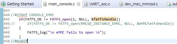

    We tried to "FATFS_Console_evmAM572x_armExampleProject" on TMDSEVM572X based on your guide.
    (Because USB_DevMsc_mmcsd_armExampleProject is prepared only for TMDSEVM572X.)
    But we failed to open eMMC with like below Error message on teraterm console".
    Question:
    Do you have same experience with below detail procedure with "pdk_am57xx_1_0_13" in PROCESSOR-SDK-RTOS-AM57X  05_02_00_10?
       1: build "USB_DevMsc_mmcsd_evmAM572x_armExampleProject".
       2: Formatting the EMMC to FAT32 by Windows-PC under running "USB_DevMsc_mmcsd_evmAM572x_armExampleProject".
           (We can copy a "txt-file" to eMMC of TMDSEVM572X and open the txt-file with text-editor on Windows-PC.)
       3: At first, build & run "FATFS_Console_MultiPartition_evmAM572x_armExampleProject".
           (This sample seems to be support eMMC by default such as "#ifdef MULTI_PARTITION, CONSOLE_EMMC".)
           -> But we found Error such as "eMMC Fails to open".
       4: We also tried to modify code of "FATFS_Console_evmAM572x_armExampleProject".
           -> We also found Error such as "eMMC Fails to open".
    We would appreciate if you check the behavior with your TMDSEVM572X and tell us how to solve this problem.
    Please use the pdk_am57xx_1_0_13 for the test. There is a USB_DevMsc_mmcsd_evmAM572x_armExampleProject, it has -DUSB_DEVICE_EMMC in the compiler option, so this project is used to access the EMMC from the USB port. I tested it on AM572x GP EVM, my Windows PC detected a unknown USB driver. You can format it. If this is the first time you access the EMMC, it is not partitioned so formatting will fail. You can use the Windows PC, administrative tools====>computer management=====>Storage====>disk management to partition it. After that, I was able to write/read files from EMMC.
    Then, there is a FATFS_Console_MultiPartition_evmAM572x_armExampleProject used for accessing multiple partitions: it has -DMULTI_PARTITION and -DCONSOLE_EMMC in the compiler options. So it opens both MMCSD and EMMC. When you run it, the console asked you to select a partition to access, like below:
    0:/
    1:/
    2:/
    Select drive :
    This showed there are 3 partitions (depending how many partitions in the MMCSD), EMMC should be the last one, the first ones are from MMCSD. It worked for me on AM572x GP EVM as well. I can access the EMMC.
    Above two projects are available on AM572x GP EVM, you need to port them to idkAM574x.
    Regards, Eric

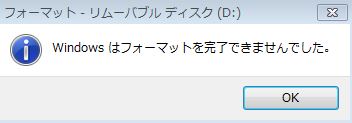

    Thank you very much for your kindness.
    I really appreciate your help.
    I'd like to check the behavior.
    But we fail the format by windows7 like below, at that time.
    I explained you need to Windows PC, administrative tools====>computer management=====>Storage====>disk management to partition it. Please search internet how to use disk management if it worked.
    Regards, Eric
