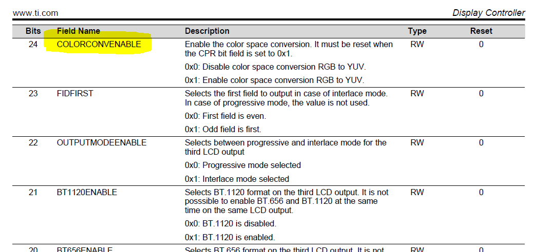

Hi all,
I have TDA2p board with following setup:
LCD pins on TDA2p are connected to Parallel-to-CSI converter. PAR2CSI is connected to UB953 and video is sent over FPD link. I managed to send 1080p@30fps RGB888 video and successful capture that video on another board. Our customer requirements are to send 1080p@60fps YUV422. The question I have is: Is it possible to send YUV422 video over LCD? According TRM, it is possible to enable/disable color space conversion:
In fact, video is already in YUV422 format, I would like just to bypass conversion to RGB. Is this possible and if it is possible, please give me short guidelines what changes are required.
