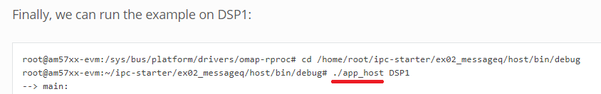

    I just checked the directories you mentioned and the good news is that the Debian image provided by beagleboard has all the things you mentioned. Now I can soft link the  dra7-dsp1-fw.xe66 to my .out file and reload the DSP1 with this executable. But to run it, I must have the app_host file as stated in the link:
    and this "app_host" is in the ex02_messageq example which itself is in the RTOS SDK as stated in the link:
    could you please provide me a zip file containing this example? I don't want to install RTOS SDK just because of this example.

  • Hi, Zana,
    Do you just need the binary of app_host? All IPC example binaries are located in /usr/bin/ipc/examples. You may want to start with both host and dsp binaries of ex02_messageq in the release package instead of your .out file as the baseline. The app_host is written as an messageq example to work with that for DSP. It may not work with your dsp application.
    If you want the source code of ex02_messageq, please install RTOS SDK to get it.
