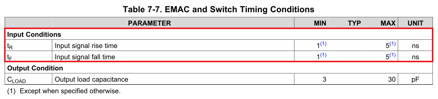

The transition time for RD and RX_CTL were removed from Table 7-19 on the datasheet which is changed from SPRS717J to SPRS717K.
For the transition time for RD and RX_CTL, do the input conditions in Table 7-7 apply to?
Daisuke
Daisuke
-DK--san,
Thank you for your reply.
Table 7-19 is Timing Requirements, not Switching Characteristics. The maximum transition time for the input signals of RD and RX_CTL should be provided in data manuals.
If not so, when the setup and hold requirements are met, are the transition time requirements which are not provided in data manuals also met?
Daisuke
-DK--san,
I understand the transition time for RD and RX_CTL as follows:
For 10 Mbps, when the pulse duration for RXC is 240ns the transition time of 238ns is allowed for RD and RX_CTL.
For 100 Mbps, when the pulse duration for RXC is 24ns the transition time of 22ns is allowed for RD and RX_CTL.
For 1000 Mbps, when the pulse duration for RXC is 4.4ns the transition time of 2.4ns is allowed for RD and RX_CTL.
Is my understanding correct?

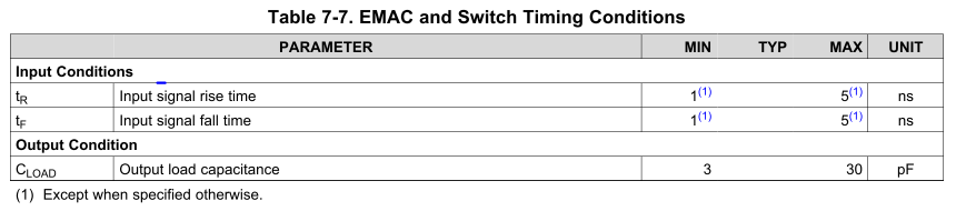

Daisuke
Maeda-san,
After further review it appears that I was incorrect in my previous response. The correct answer is:
TI will continue to publish *input* Rt/Ft in Sitara data manuals. Instances where this data was recently removed were done in error and will be corrected in the next revision of the affected document. The values will remain the same as they were prior to removal.
TI will no longer publish *output* Rt/Ft in Sitara data manuals. Instances where this data currently exists will be removed upon the next revision of the affected document.
Please accept my apology for any confusion this may have caused.
