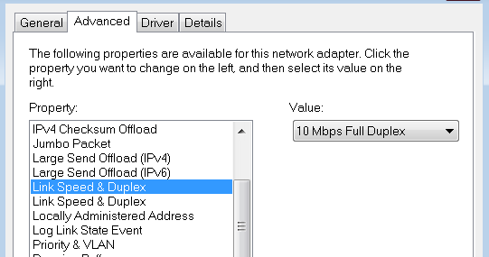

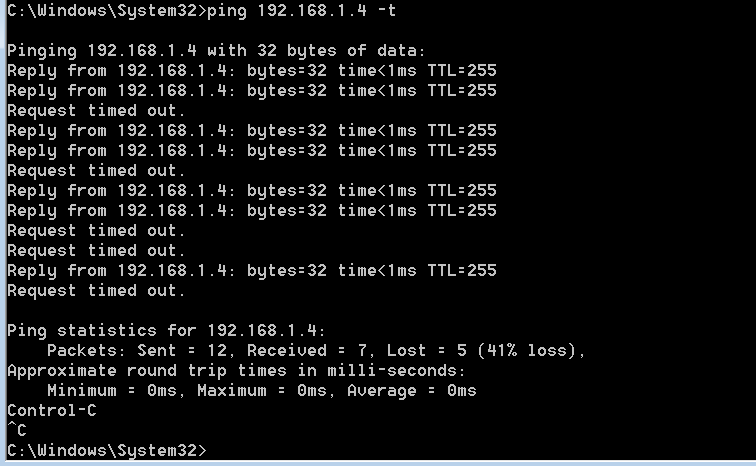

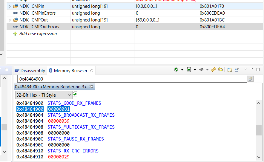

    I tested the NIMU_BasicExample_idkAM572x_armExampleproject of Processor SDK RTOS 5.2 release ( pdk_am57xx_1_0_13) on AM572x IDK EVM (this is the same as idkAM574x in Ethernet part), using J10 port.
    On 1Gbps through auto-negotiation, I don't see any problem using ping.
    In the host Windows 7 PC, I changed the link speed to 100 Mbps, ping still worked. Then, I changed to 10 Mbps. The ping failed intermittently. I opened a ticket for this.
    Changing link speed:
    Got link as Negotiated connection: HalfDuplex 10 Mbs

    There is ping loss:

    Can you explain what is your test setup? Is the other side a windows or Linux PC? Did you configure the network adapter to 10Mbps full duplex or 10Mbps half Duplex? I saw your AM574x EVM UART console log showed half Duplex.
    And what is your real usage case with 10Mbps Ethernet? What is connected?
    For the failure we reproduced here, if you still have the setup for quick test. Can you:
    1. Rebuild the NIMU test application by commenting out the app_stats() task. This task periodically query the CPSW statistics then clear it (so we can't see the counters in an accumulated way in CCS).
    #if !defined (NIMU_DUAL_MAC_MODE) && !defined (NIMU_FTP_APP)
    Task_Params_init(&taskParams);
    taskParams.priority = 9;
    taskParams.instance->name = "EmacStats";
    //Task_create(app_stats, &taskParams, NULL);
    #endif
    2. In CCS expression window:
    3. In CCS memory window:
    We looked at the NDK_ICMPIn[8], NDK_ICMPOut[0] and found the In/Out matched each other and the increment matched the ICMP received by PC. NDK_ICMPInErrors and  NDK_ICMPOutErrors are clean.
    The CPSW host port stat showed RX_CRC_ERRORS (address 0x48484910), the increment matched with the number of the ICMP packet not replied.
    Will you see the same behavior? If yes, the issue is not in the NDK/NIMU driver. But maybe underlying PHY issue we continue to debug.
