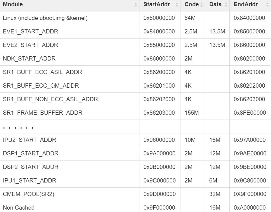

We are ready to use EVE, But, after cold reboot, sometimes, it will attach EVE fail, about seventy percent . And then, if we execute reboot command, it will be  normal, everytime.
On the other hand, we followed the chapter 6.6 of VisionSDK_UserGuide_MemoryMap to change the map to 512MB DDR.Because, Our board's DDR size is only 512MB.
Please find the log in the attachment.

  • Hi Terence,
    I've attached a sample patch we had on TDA2x to enable EVE-1 (and later modified to use EVE-2).
    Can you apply these patches for TDA2p and let us know your observations? Please enable EVE-2 (instead of EVE-1), and make the board config as tda2p instead of tda2.
    Shravan

  • Hi Shravan,
    After applying your patches, this issue still remain. Please find the log in the attachment.

  • Hi Shravan,
    In your patches, about EVE, the total size of vecs+code+data are over the size reserved in the dts. I don't understand why? Are you sure it is right?
    Terence
    ========================.xs in your patches================================
    EVE1_VECS_SIZE = 0.5*MB;
    EVE1_CODE_SIZE = 2*MB;
    EVE1_DATA_SIZE = 10.5*MB;
    EVE2_VECS_SIZE = 0.5*MB;
    EVE2_CODE_SIZE = 0.5*MB;
    EVE2_DATA_SIZE = 0.5*MB;

  • Hi Shravan,
    According to local TI employee's suggestion, we change the PROFILE ?= release to PROFILE ?= debug in the cfg.mk. It is normal now for attaching EVE, after cold reboot. We try it 10 times.
    Do you know why?
    Thanks a lot
    terence

  • Hi Terence,
    Based on your config I would recommend a couple of debug steps:
    1. Modification of memory map config:
        a) Can you increase the retain the code and data-size provided for the EVEs? Let the EVE_1_CODE_SIZE = 2MB and the EVE1_DATA_SIZE=13.5MB and similarly EVE2_CODE_SIZE=2MB and EVE2_DATA_SIZE=13.5MB. Make the corresponding changes to the Linux DTB too.
        b) Can you decrease the SR-1 size to 160MB? This will provide you the space you need for increasing the EVE size.
    2. Can you add a slight delay before the loading of the EVE firmware:

  • Hi Terence,
    Can you please share the memory map changes made (in both VSDK and kernel) for moving the address.
    Shravan
  • Hi Shravan,
    Please find the memory map we used in the attachment. I changed the IPU2 address from 0x98000000 to 0x96000000. I modified four files, include mem_segment_definition_linux.xs, system_vring_config.h, dra76-evm-infoadas.dts, and  dra76-evm.dts.  Below is the patch for moving the address.
    --------------------------- mem_segment_definition_linux.xs--------------------------
    -IPU2_START_ADDR = 0x98000000;
    +IPU2_START_ADDR = 0x96000000;
    --------------------------system_vring_config.h-------------------------------------------
    #ifdef BUILD_M4_2
    -#define IPU_PHYS_MEM_IPC_VRING 0x98000000
    +#define IPU_PHYS_MEM_IPC_VRING 0x96000000
    #endif
    ----------------------dra76-evm-infoadas.dts----------------------------------------------
    &ipu2_cma_pool {
    - reg = <0x0 0x98000000 0x0 0x2000000>;
    + reg = <0x0 0x96000000 0x0 0x2000000>;
    --------------------dra76-evm.dts----------------------------------------------------------------
    - ipu2_cma_pool: ipu2_cma@98000000 {
    + ipu2_cma_pool: ipu2_cma@96000000 {
    compatible = "shared-dma-pool";
    reusable;
    status = "okay";
    Terence
  • Hi Terence,
    My guess is this is an issue with the timing that EVE-2 firmware is loaded. Can you revert to the older memory map configuration and add the below snippet of code? I wan't to introduce some delay before loading EVE-2.
    diff --git a/links_fw/src/rtos/utils_common/src/utils_eveloader.c b/links_fw/src/rtos/utils_common/src/utils_eveloader.c
    index 0a97fa6..fbcde98 100644
    --- a/links_fw/src/rtos/utils_common/src/utils_eveloader.c
    +++ b/links_fw/src/rtos/utils_common/src/utils_eveloader.c
    @@ -142,7 +142,7 @@ Int32 Utils_eveBoot(void)
    pmhalPrcmDpllConfig_t *dpllParams;
    pmhalPrcmSysClkVal_t sysClkFreq = PMHALCMGetSysClockFreqEnum();
    sbllibInitParams_t sblInitPrms;
    + volatile uint32_t counter =0;
    /* Default initialization of SBL Lib Params */
    SBLLibInitParamsInit(&sblInitPrms);
    @@ -181,6 +181,10 @@ Int32 Utils_eveBoot(void)
    SBLLibEVE1BringUp(gUtilsEntryPoints.entryPoint[SBLLIB_CORE_ID_EVE1],
    sblBuildMode);
    #endif
    + while(counter < 100000000) // introduce a delay of about 500ms before loading EVE-2
    + counter++;
    + if(counter > 100000000)
    + Vps_printf("Counter complete");
    #ifdef PROC_EVE2_INCLUDE
    SBLLibEVE2BringUp(gUtilsEntryPoints.entryPoint[SBLLIB_CORE_ID_EVE2],
    sblBuildMode);
    Shravan

  • Hi Shravan,
    According to your suggestion, to introduce a delay, this issue still remains.
    On the other hand, in your code, it will never printf "Counter complete". Are you sure the counter need to add 1000000, or 10000000? which will be equal with 700ms,?I guess 10000000, but it still not work.
    Terence
  • Hi Shravan,
    If I modified PROFILE ?= debug in the cfg.mk, it will be normal, I said this before. But, I don't know why?
    Terence
  • Hi Terence,
    The issue has been identified to be a problem in setting up the EVE-MMU configuration. Can you add the below delay:
    --- a/links_fw/src/rtos/bios_app_common/tda2px/eve2/src/tlb_config_eve2.c
    +++ b/links_fw/src/rtos/bios_app_common/tda2px/eve2/src/tlb_config_eve2.c
    @@ -96,7 +96,11 @@ void eve2MmuConfig(void);
    -    eveCommonMmuConfig(SOC_EVE_MMU0_BASE);
    +    volatile uint32_t debugWait=0;
    +    while(debugWait < 10000000)
    +    debugWait++;
    +    if(debugWait)
    +        eveCommonMmuConfig(SOC_EVE_MMU0_BASE);
    +    while(debugWait < 20000000)
    +    debugWait++;
    If the above still fails, can you continue to build only your EVE firmware in debug mode?
    Shravan
  • Hi Shravan,
    Thanks a lot.
    According to your suggestion, I recover the PROFILE ?= releaase in the cfg.mk, and add a delay in EVE-MMU configuration. I try it 10 times, it is normal now.
    Terence
  • Dear Terence.
    We found EVE2 setup need a little more time. Please help merge attached change and let us know the test result. Thanks a lot
