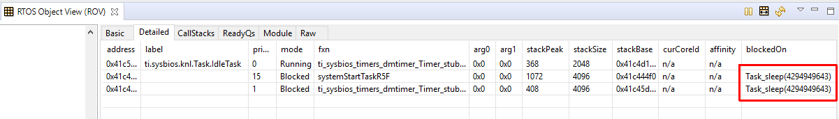

With this interrupt priorization, the tasks die after some seconds.
Then, when starting ROV, I can see that they suddenly do a Task_sleep(4294949643) which is 0xFFFFBB0B instead of Task_sleep(1).
Now my assumption is that the RTOS/HAL interrupt handler has a bug, so that some memory regions get overwritten.
Proove: When I turn the priority of my interrupt from 5 to 15, everything works well !

  • It's behaving as though interrupts have been disabled for more than a Clock_tickPeriod (ie more than 1ms).
    This can cause the timeout value in the Clock objects used by Task_sleep() to get improperly evaluated.
    Have you tried different maskSetting values? Does Hwi_MaskSetting_LOWER or Hwi_MaskSetting_SELF behave better?

    If you let the application run more after the condition occurs, can you confirm that the Clock 'ticks' value is increasing in the Clock module ROV view? If not, then a Clock timer interrupt was not properly serviced.
