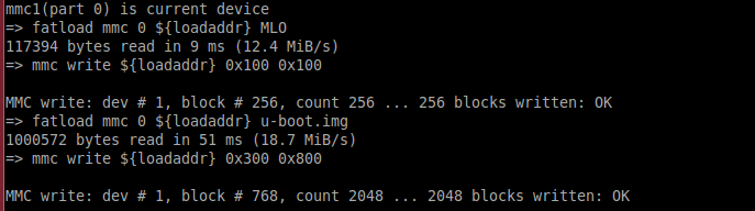

 I have recently upgraded u-boot from v2017.01 to v2018.01 , with sdcard the images are working fine but when i tried to flash the MLO and u-boot.img into emmc  I'm not able to boot the board.
Below is the log when booting from emmc

After that the board is going into hang state.
can any one help me out to debug this issue
