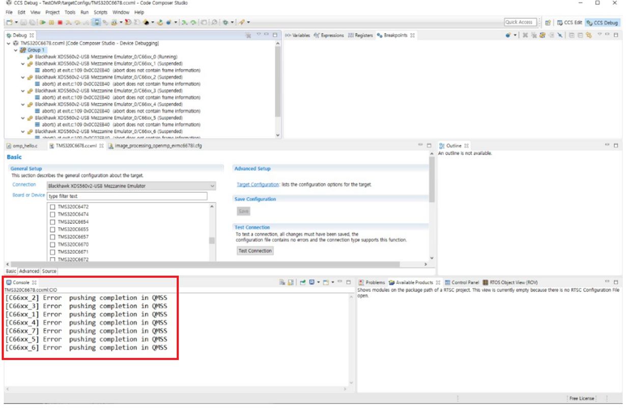

I tested the OpenMP sample project.
It confirmed that eight cores were being executed. (using OMP 1.2.0.5)
It changed to cfg file and platform for the MCSDK Image_processing demo project config. To use NDK.
However, running results in the following error:
Why does it run like this?
My project file is as follows.  TestOMP_20190503_ImageProcess cfg.zip
Thanks.
  • lld_init()modified the function and the symptoms changed.
    OpenMP implementation is strange, and the following error.
    How do I get rid of the errors?
    It is running on the 6678 EVM board. Give me some advice.
    Project file is TestOMP_20190503_lld_init EXE.zip

    We can provide some general suggestions for the obsolete MCSDK release. It's really difficult for us to reproduce and debug the problem like you described above. I would strongly recommend you move to the latest processor SDK and we can help resolve any issue you may observe there.

    There is no OpenMP + NDK project in the latest SDK today. I have requested to add one example into later releases. If you have any issue to integrate OpenMP with NDK using the processor SDK, just let us know.
