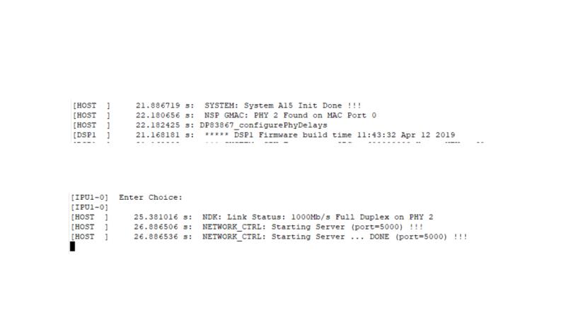

  • I think hardware part is OK,and I also tried according your sugesstion, but it still dosn't work.I pasted the hardware board indicator video.
  • Below is the log, after I insert the phy delay function into my code, but it still dosn't work. Do you have any suggestions?
  • Hi Yongliang,
    Your logs tell me that the connection with the PHY is established. When you say your code isn't working, what exactly is the error? Are you able to get an IP printed in the console?
    Anand
  • I used static IP, and after I insert the PHY delay configuration function in my code, I can't successfully ping(command) with the board(PHY is DP83867), then I used my another board running same code(PHY is DP83865), the PHY DP83865 still can run correctly, I can easily feed video by my labtop to the board, so I guess may be my inserted function dosn't work anymore. I confused. Thank you for your reply!
  • Hi Yongliang,
    I believe the configureDelays function might not be getting executed. Can you put a breakpoint inside the function and see if it is hitting? Also, make sure that if there are any SoC specific if conditionals or # defines, comment them out so that the function blindly configures the delays for you.
    Anand
  • I printed some information in the configure delay function, and I saw the information from the initialize Log. I will check the platform related compile option next, after I get the result, I will reply you. I guess may be because of some ethernet related hook, have some limitation on calling the PHY configuration function.Thank you!
