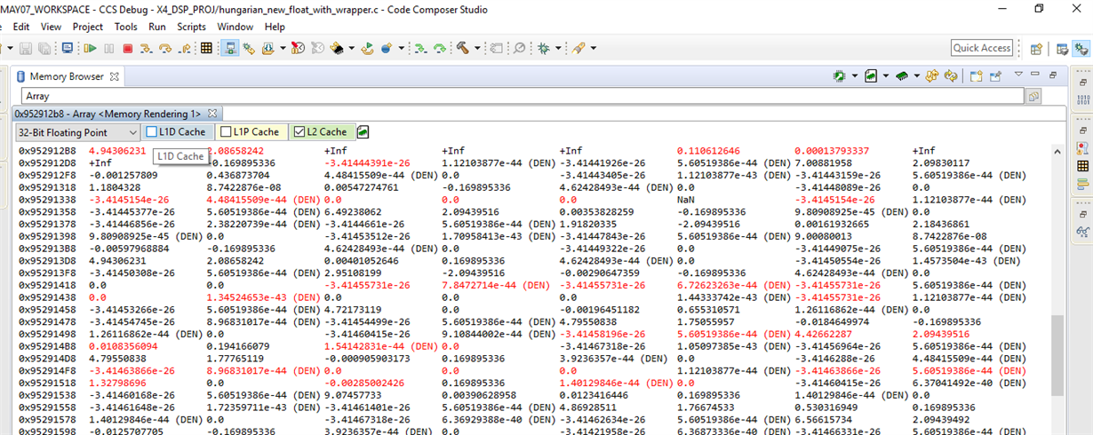

  • Hi George ,
         I don't have permission to  send  the entire project , I have checked the assembly code observed that there is some cache problem , some memory corruption is happening there. If you check that buffer in the memory browser  values  different when L1DCache is enabled and Disabled , is there a way to fix this problem .
    With L1DCache disable
    So if condition is not comparing the proper values , it is comparing some different values and gives the results based on that, so please suggest how to fix this problem.

    I knew that L1DCFG = 4, that is 32KB cache.
    Did this reproduce your issue?
    Then I modified L1DCFG  = 0, that is 0KB cache. I got the same CIO console output. So I am not sure what is the indication of issue reproduced and how you disable L1D and made the difference?
    Regards, Eric

    Thanks for explanation! I was able to reproduce the issue, however, I don't see any L1D setting caused the problem. But I believe it is a compiler issue and I asked my colleague to follow up.

    With L1DCFG (0x0184_0040 = 0x4, 32KB cache), I saw results 0.0, 6.0, 0.0.
    With L1DCFG = 0, No cache, I still saw results 0.0, 6.0, 0.0.
